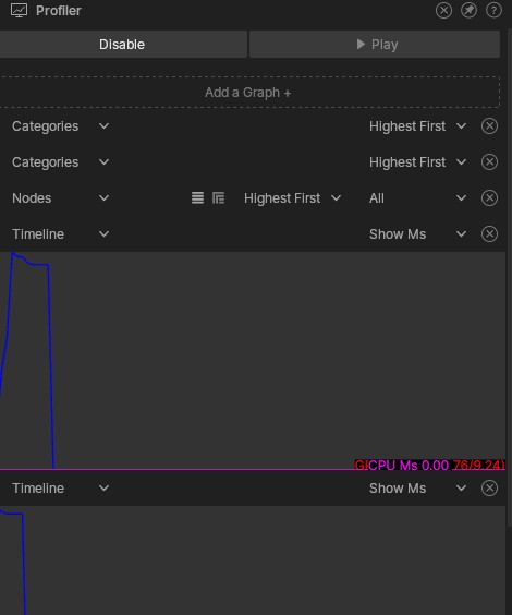

If you would like more details on what aspects of the scene are taking the GPU time you can use the Notch Profiler. See the Profiler section of the manual to for information on how best to use it.
profiler
The profiler also allows you to see what aspects of the Notch render pipeline are taking time, to allow you to make some educated decisions.
