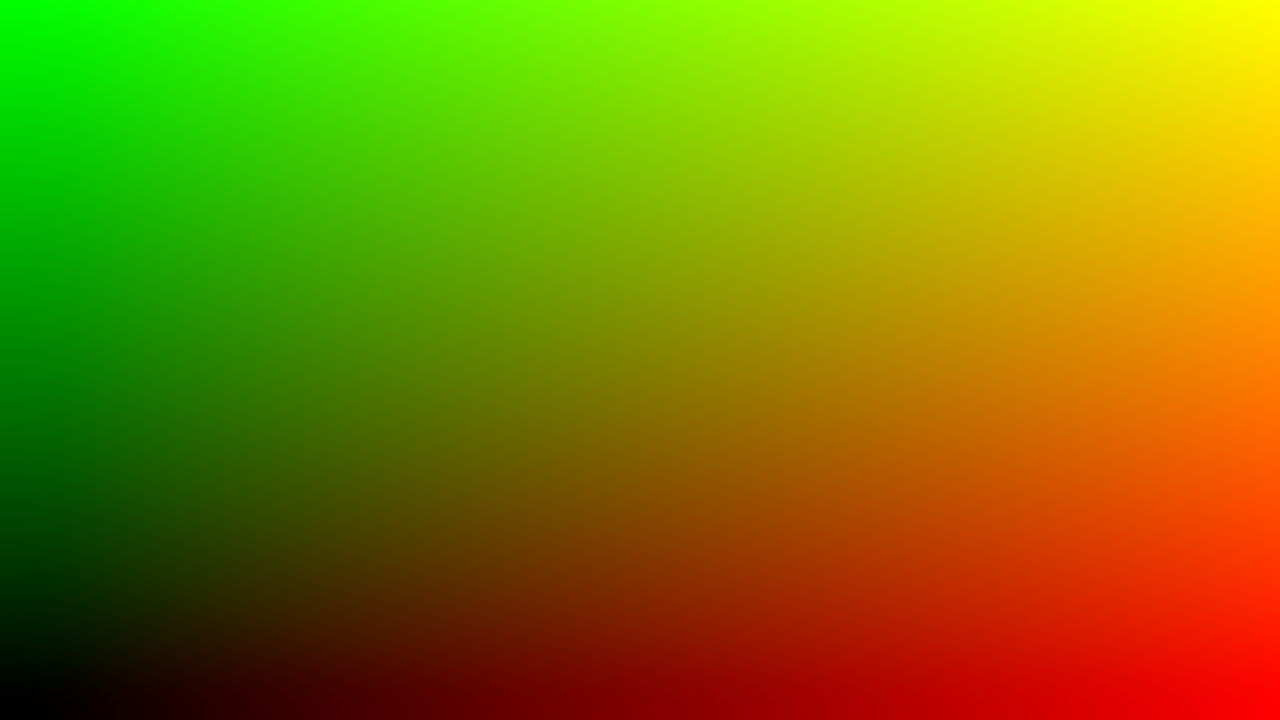

Creating a UV Remap Texture #
The start of any UV remapping workflow is to have a good UV remapping texture to use to insert into your content. The UV remapping texture is what will be used to save and then reference the UV co-ordinates for each pixel, so the data that is stored in the UV remapping file needs to be in the correct format otherwise you could get a compressed or warped output.

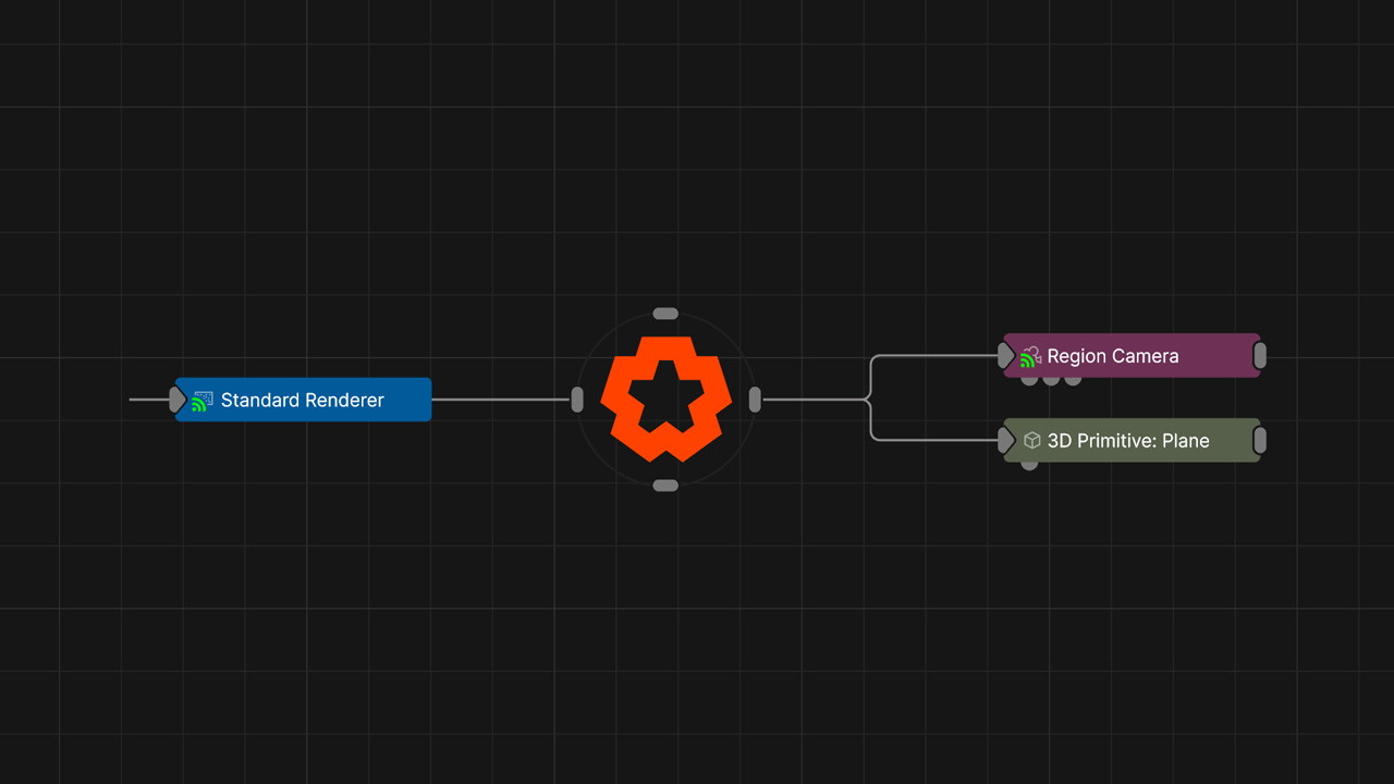

The easiest way to do this in Notch is to render the UV co-ordinates of a 3D screen. This will give us the horizontal linear gradient on the red channel, and the vertical linear gradient on the green channel.
To set this up you can:
  • Add a screen to your scene (make sure it is the correct aspect ratio) by using a 3D Primitive node set to plane, and adjusting the size to match your aspect ratio.
  • Set up a Region Camera to perfectly capture the screen by setting it to orthographic, and setting the top left and bottom right positions to match the corners of the plane.
  • Make sure you have no antialiasing set in the renderer.
  • Send this to the Render Queue by right clicking on the composition name in the right hand side of the nodegraph and selecting “Add Composition to Render Queue”.
  • Render out an EXR UV pass of the scene by setting “AOVs” to On, and setting “AOV 1” to UV.

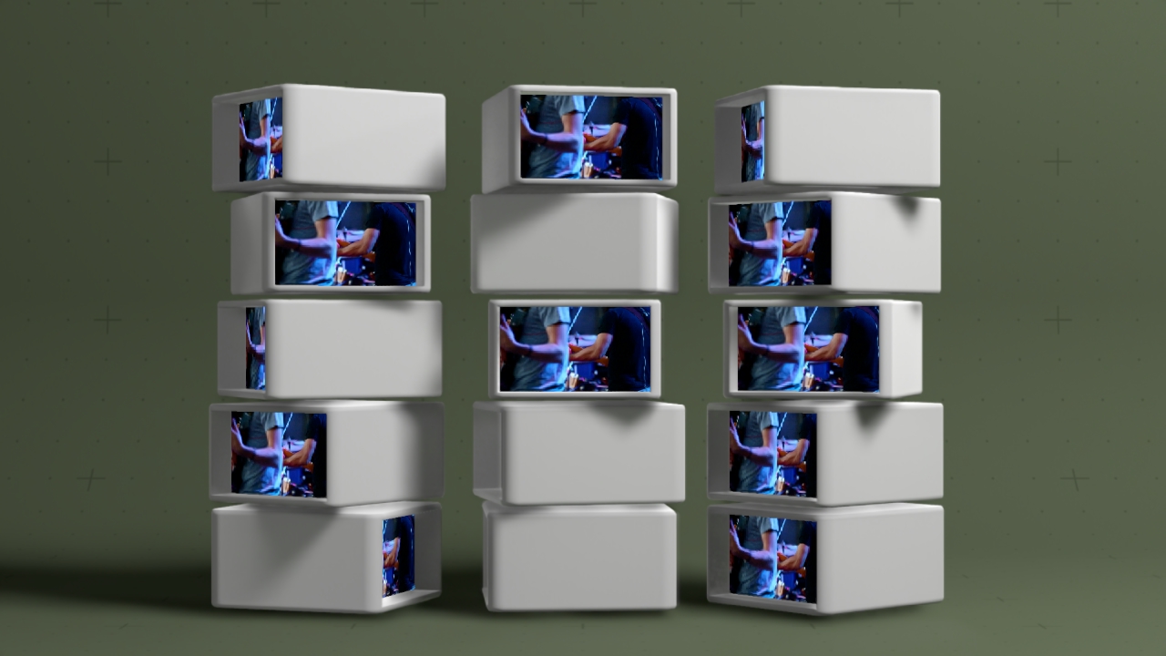

Here is a scene where we have an animated cloner system which has the UV remapping texture parented to each clone.
The idea here is that we would have a rendered video pass of the cloner cubes, background and lighting, but then have a separate UV pass which we can apply live video to.

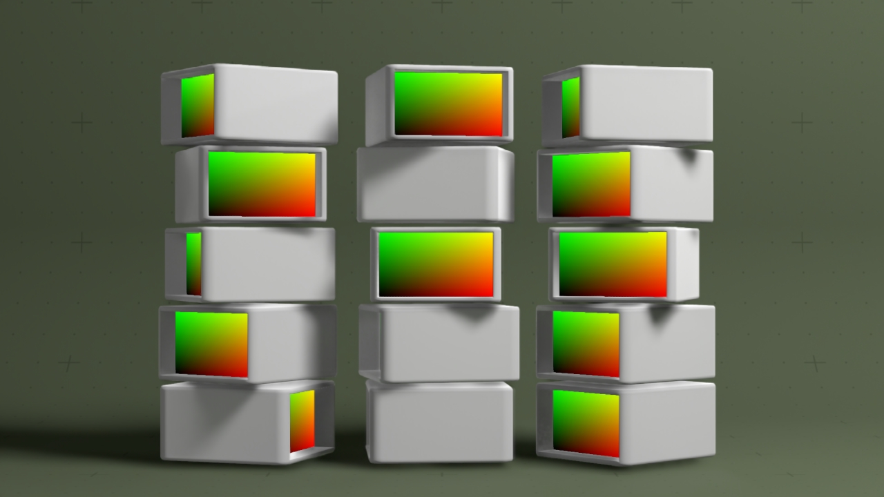

UV Remapping Pass

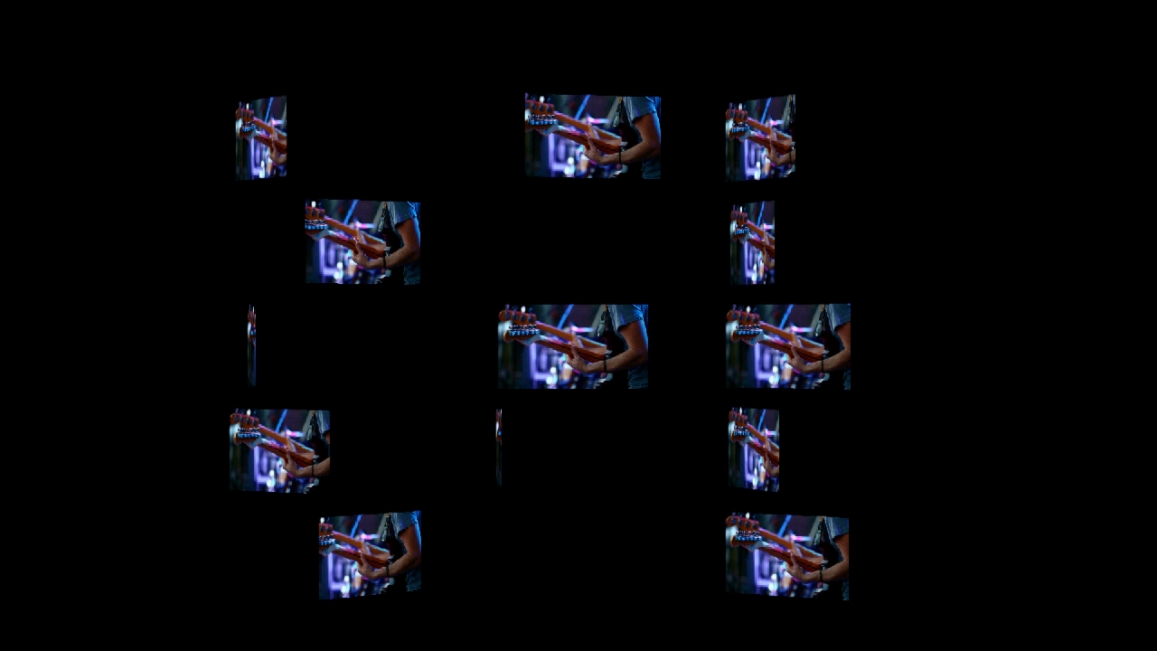

Video Applied

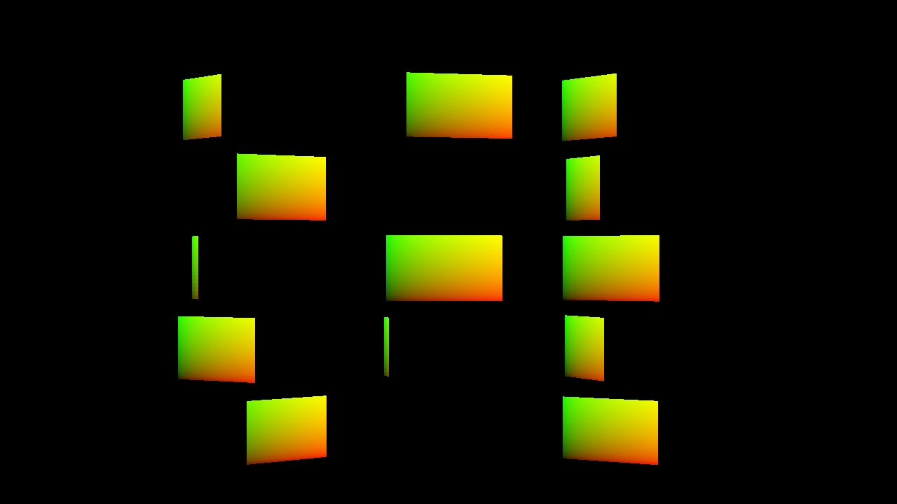

To output the UV remapping pass correctly, the best practice is to first output it to a 16/32-bit EXR sequence before re-encoding it to Quicktime UV Animation.

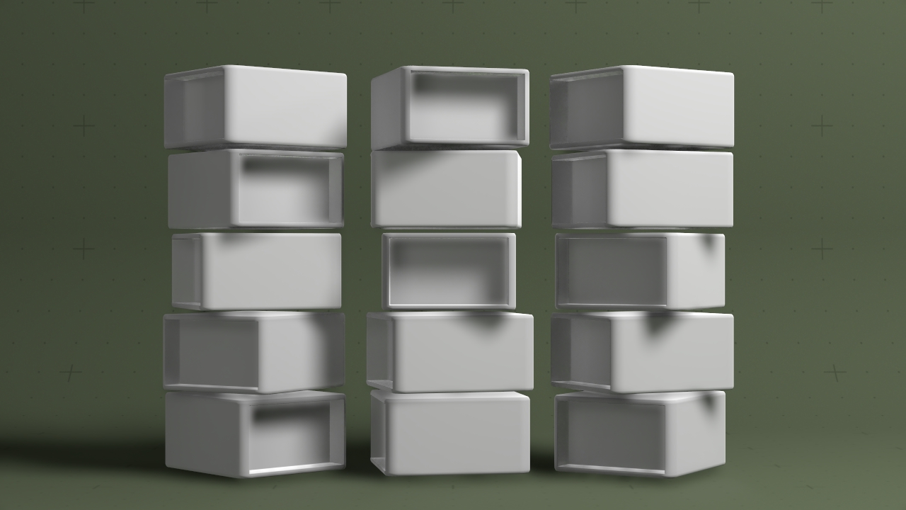

Main Pass
UV Remapping Pass

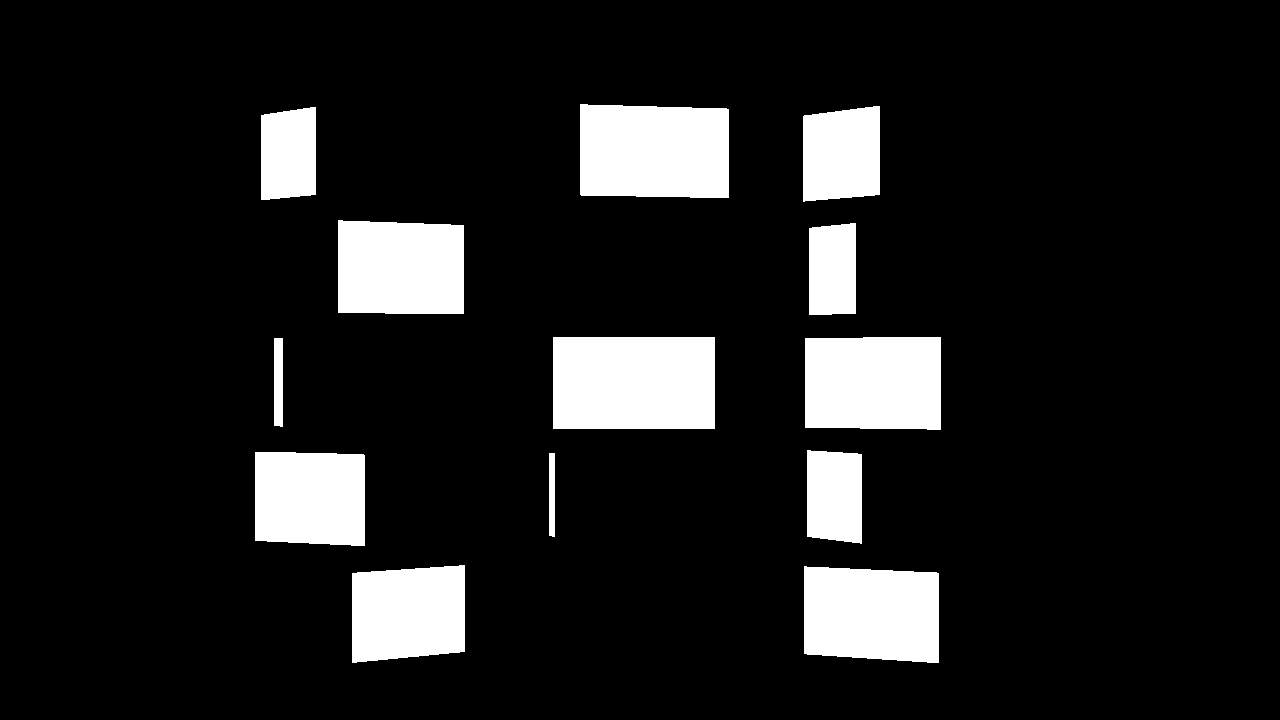

Making A Mask Texture #
When using UV remapping textures, it is advised to use a mask to mask out the background of the remapped texture. This is because with UV remapping textures, a black pixel value represents the UV co-ordinate [0,0], so if there is colour at pixel [0,0] in the source image, and the UV remapping texture background is black, then the background will be the colour of pixel [0,0]. So creating a mask allows you to black out any bits of the texture you want to stay black.
Masking also helps with the anti-aliasing of the UV remapping texture. When creating the UV remapping pass, it can sometimes be helpful to use an anti-aliasing mode that prioritizes the quality of the texture, and then use a mask with a different anti-aliasing mode to get smooth edges.
Creating the mask can be done as another pass in the render.
In the example project, the mask is created by turning all lighting off, changing the necessary objects in the scene to black, and setting the screens to output white. So what is left is a mask that is white where the screens are and black where they are not. The screens are also scaled very slightly smaller in the mask composition so that the anti-aliased mask smooths the edges of the final output.

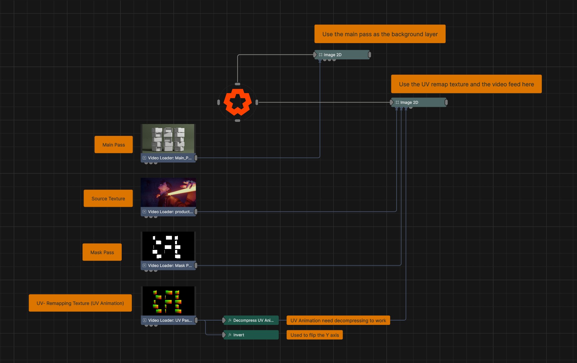

To setup UV remapping in Notch, you just need to:
  • Add an Image 2D
  • Connect the main pass to the “Video Node” input of that Image 2D
  • Add another Image 2D
  • Connect the source image to the “Video Node” input of that Image 2D
  • Connect the UV remapping pass to the “UV Remap Image” input of that Image 2D
  • Add a Decompress UV Animation node to the UV remapping pass. (Only necessary when using the Quicktime UV Animation codec)
Optional steps:
  • Using an Invert post-FX node is useful for flipping the UV co-ordinates of the UV remapping texture. Some programs will export the UV co-ordinates upside down or back to front. Set the “Affected Channels” to just R, just G, or both to flip the corresponding axes.
This will now reference the UV remapping texture to determine which pixel from the source texture gets applied to the output.
