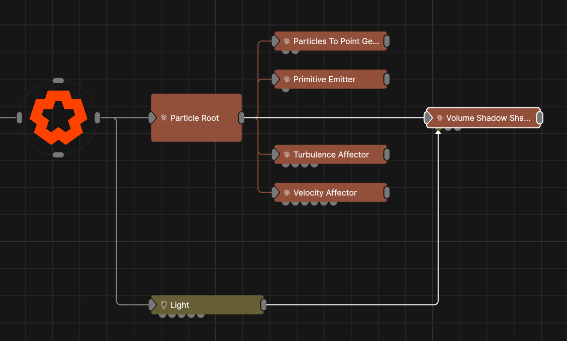

Light particles using shadow volumes.
This node shades particles using a shadowing function from the point of view of a Light Node connected to the Light Node input. The shadow effect takes into account transparency of particles, so light will appear to be partially absorbed by particles rather than completely blocked by them.
The node works by splitting the volume into a 3D grid of cells, and particles within each cell are accumulated together. Setting a higher Sample Density will result in a higher density of cells in the grid, which in turn will mean less particles per cell, but will result in more realistic shadows.
This node is only effective if a Light is connected to the Light Node input. The light node must be a spot light.
