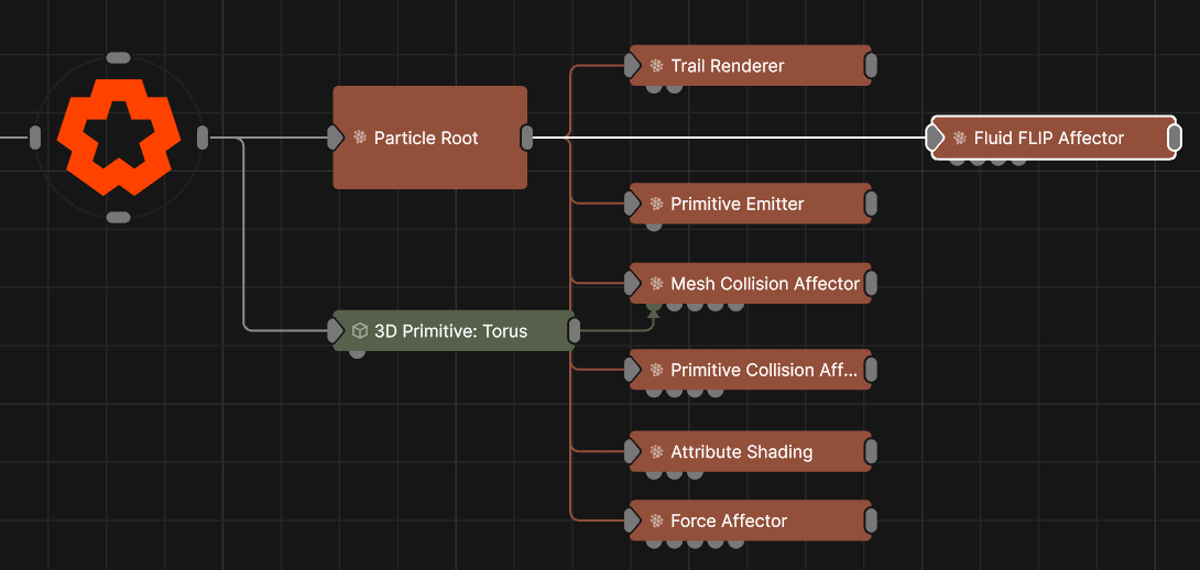

Simulates fluid dynamics on Particles with FLIP simulations.
This node simulates fluid dynamics on a particle system using the FLIP (FLuid In Particle) or PIC (Particle In Cell) simulation methods. This is typically used to simulate smoke, gas and other fluid effects. This works by transferring particle forces to a grid, solving pressure forces on the grid and then transferring the resultant forces back to the particle system. This allows particles to affect each other and to move in a locally coherent manner. The simulation is stable, detailed and efficient.
The grid resolution and size used for the pressure solver is key to the detail and performance of the resultant simulation. A higher resolution grid over a smaller area will give a more detailed simulation, but higher resolution grids are slower to process. The simulation may be switched from 3D to 2D, in which case one axis is dropped from the simulation.
