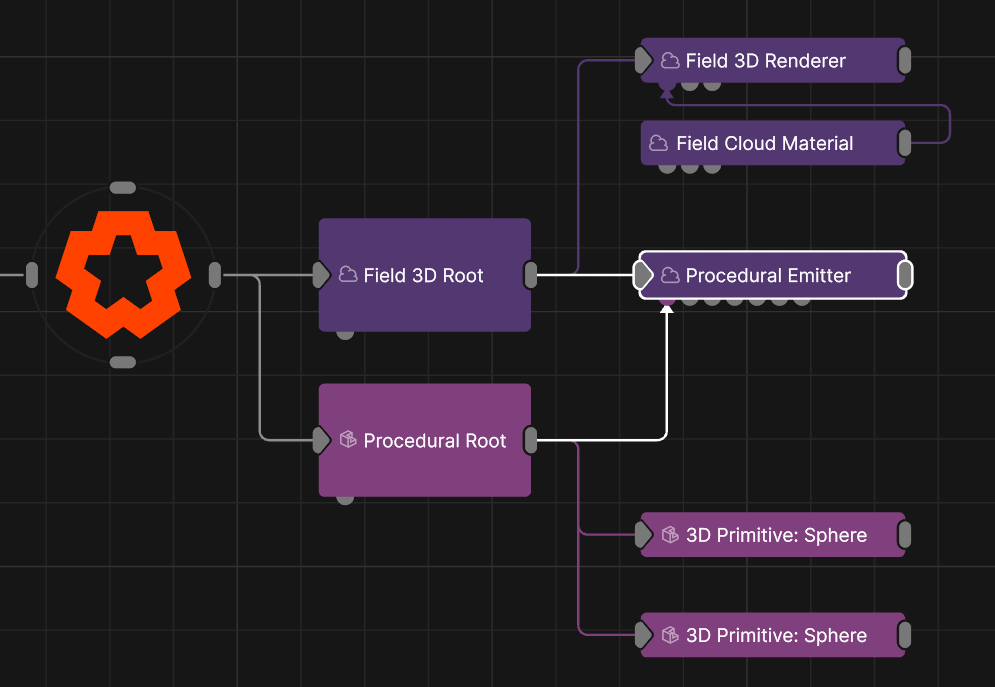

This node emits colour/ink into a field using a procedural system.
A Procedural root must be connected to the Procedural Root input with a valid procedural generated for this node to emit anything.

| Procedural Root | Connect a source procedural system to generate the field. A procedural node must be connected for this node to function. | Procedural Root |
| Bounding Box | Limits the area that the procedural emitter will use. | Bounding Box |
