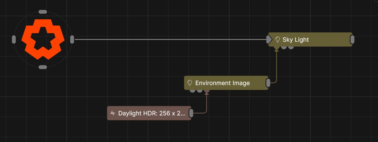

This node generate a simple sky environment, including a sun, sky, and atmosphere. The generated image has a High Dynamic Range, capturing a wide range of luminance, allowing for accurate reproduction of both bright and shaded details.
It’s possible to adjust the position of the HDR environment in 3D space to control the orientation and direction of reflections and shadows in the scene.
This node can be connected to any node which accepts an image input, although primarily used in conjunction with the Environment Image and Skylight nodes.
