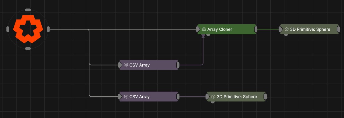

Generate an Array using a CSV file as a source.
This reads an array of transforms from a table resource. The array is used to create instances of any nodes attached to the subtree of this node - so the subtree / children are re-rendered for every transform in the array. The number of elements in the array will match the number of rows (Table) or items (Flat list) in the table.
See the Array Sources node to see how this node is used in the nodegraph to multi-instance child nodes.

The output transform array may be used directly with a Array Cloner, or to clone other nodes within a Field System or Particle System.

Channel Scale - Colour G Scale values for Colour G.
  • CSV Data : Scales the table value by this amount
  • Constant : No effect
  • Stepped : Step increases the value for every instance by this value
Channel Source - Colour B Set how the data from the CSV file is applied to the array for this property.
  • CSV Data : For each instance, set this property to the value read from the CSV file at the index defined by “CSV Index”. This is the only option that reads data from the CSV file.
  • Constant : For each instance, set this property to a single constant value defined by “Channel Offset”.
  • Stepped : For each instance, set this property by incrementally adding the value of “Channel Scale” to each instance.
CSV Index - Colour B Select the location of the data for the Colour B in the CSV file.
Channel Offset - Colour B Offsets by the given amount (regardless of CSV Data, Constant, Stepped)
Channel Scale - Colour B Scale values for Colour B.
Channel Source - Colour A Set how the data from the CSV file is applied to the array for this property.
CSV Index - Colour A Select the location of the data for the Colour A in the CSV file.
Channel Offset - Colour A Offsets by the given amount (regardless of CSV Data, Constant, Stepped)
Channel Scale - Colour A Scale values for Colour A.
