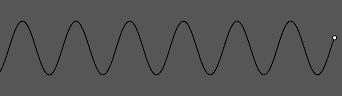

The node provides a preview of the pattern value that will be generated with a tracer line showing the place of the play head.

  • Sine : A simple sine wave. Value = 1 equals 1 second per cycle.
