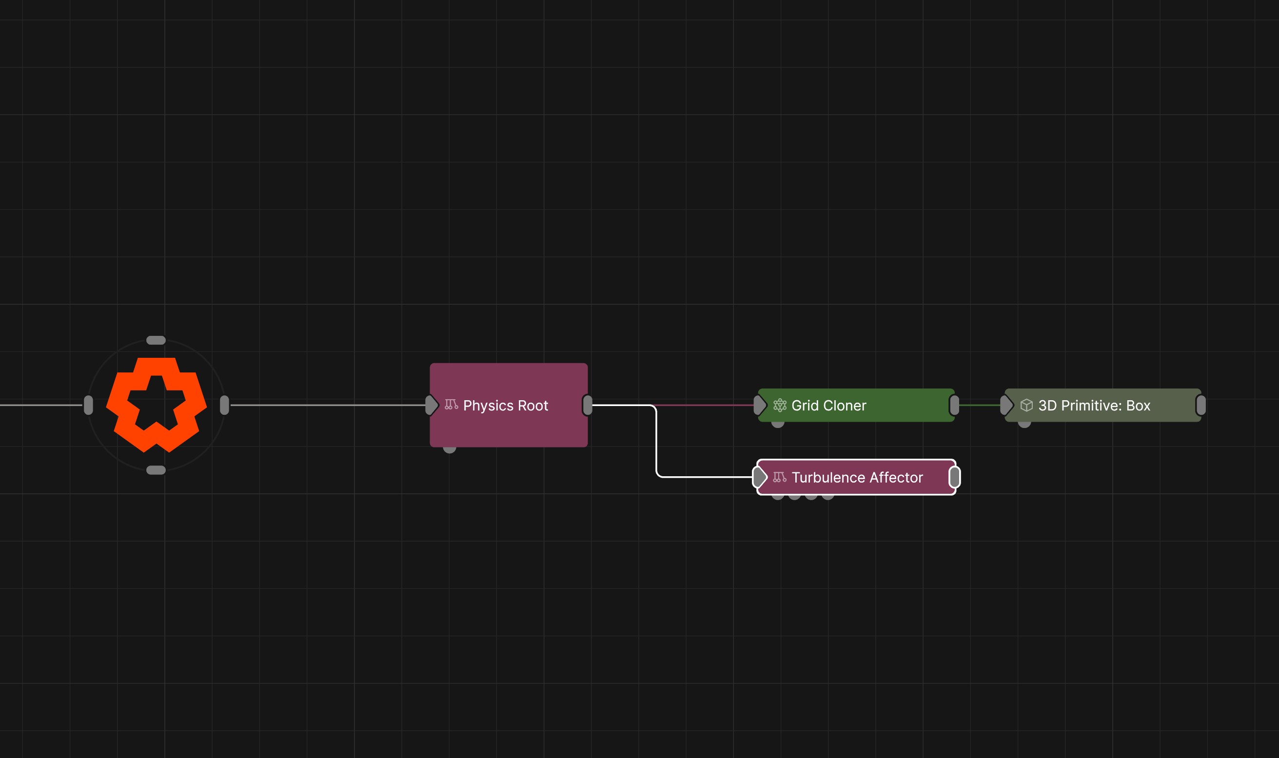

Applies Turbulence to physics objects.
This node applies turbulence to the motion of physics objects. This is typically used to apply local variations to physics objects motion, and simulate small gusts of wind. The motion is generated by using a smoothed noise field for both the direction and the magnitude of the applied velocity.
