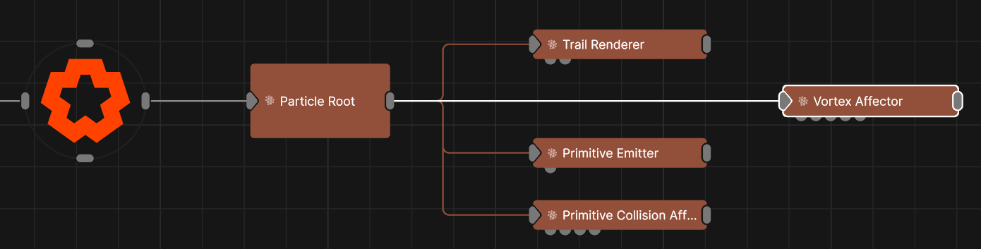

Applies a rotational velocity to particles.
This node makes particles move in a rotational manner. This is typically used to create rotational vortex effects, e.g. tornadoes.
The effect is weighted by a falloff calculated using the distance from the node to the particle, ramping from 100% at distance zero down to 0% at the distance specified by the Radius attribute.
Vortex Angle Scale Controls the effect of the angular velocity by radius, making particles further away from the centre of the vortex move faster.
Outward Velocity Blend Controls the amount particles are pushed outwards.
Vortex Position NodeOverrides the vortex transform.Null
