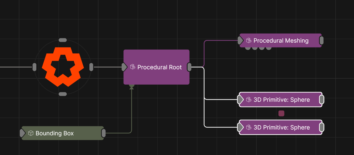

Generates a 3D primitive for a procedural.
This node generates a distance field from a primitive 3D shape.
Primitive Type Select a primitive shape to be generated into the procedural system.
