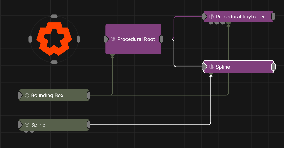

Generates a 3D Spline for Procedurals
This node generates a distance field from an input Spline. The input spline can be modified via their control points, and the procedural spline will dynamically update to match.
A mesh can be used as input if it has the Object To Lines deformer. The Duplicate Spline deformer can also be used to easily draw multiple splines.
