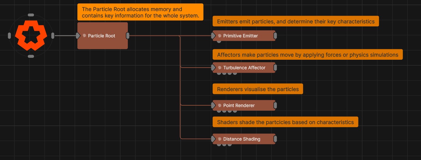

Particles live under a Particle Root node, and are created by Emitters. Once a particle has been emitted, it can be affected by Affectors. These particle positions can then be rendered by Renderers. Shading can be applied using Shading nodes. Weights can be used to control the amount another node will apply to each individual particle.
Particle Systems
The Particle Root Node #
This node is essential as the basis of a particle system. It is used to define the entire system, such as the maximum number of particles, the update rate of the system, key global properties such as size, scale and brightness. All other particle nodes must be parented to this node to add them to the particle system. See the Particle Root’s Reference Page for a guide to it’s properties.

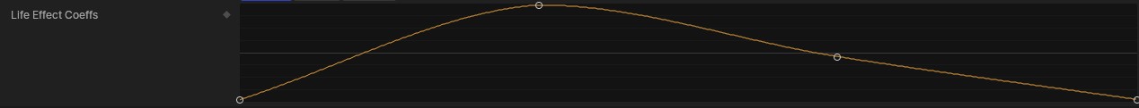

Life Effect Coefficients #
This lets you scale the amount that the affector will be applied at different times throughout a particles lifetime. The y axis of this graph is the particle affector scale amount. The x axis is the normalised lifetime of the particle. In this example, the affector amount would increase fairly quickly to a maximum and then die away.
Life Effect Coeff.

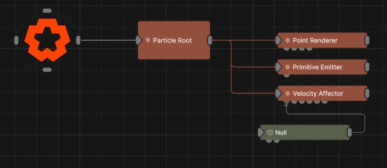

Transform Node Input #
You can feed any node into this input pin to modify the affector’s position by the position of another node. This can be useful if you want to tie the affector to another 3D object.

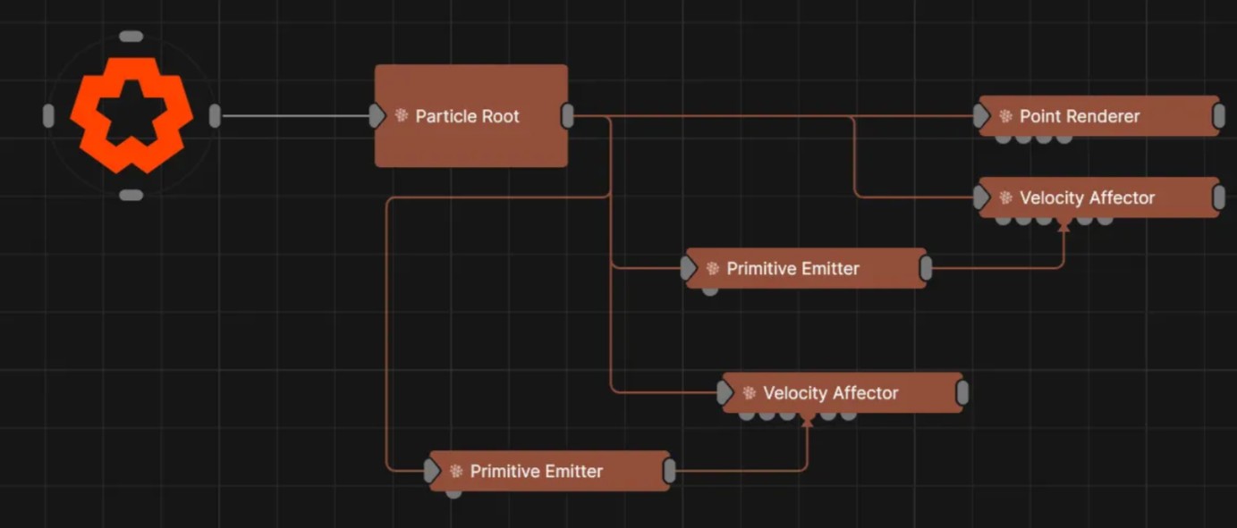

Affected Emitters Input #
By default, when its connected to a particle root, an affector will be applied to all particles within its radius. This input can let you target certain affectors to certain emitters’ particles only.
Affected Emitters

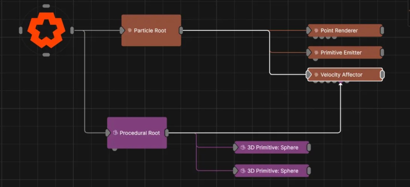

Procedural Falloff Input #
This input pin can be fed by a Procedural System to determine the volume in which the affector will be applied. This lets you customise the area of the affect however you like.
Procedural Falloff
