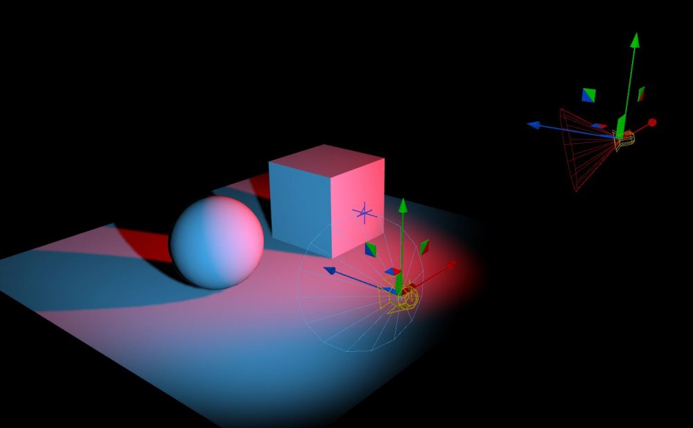

Add a point or spot Light.

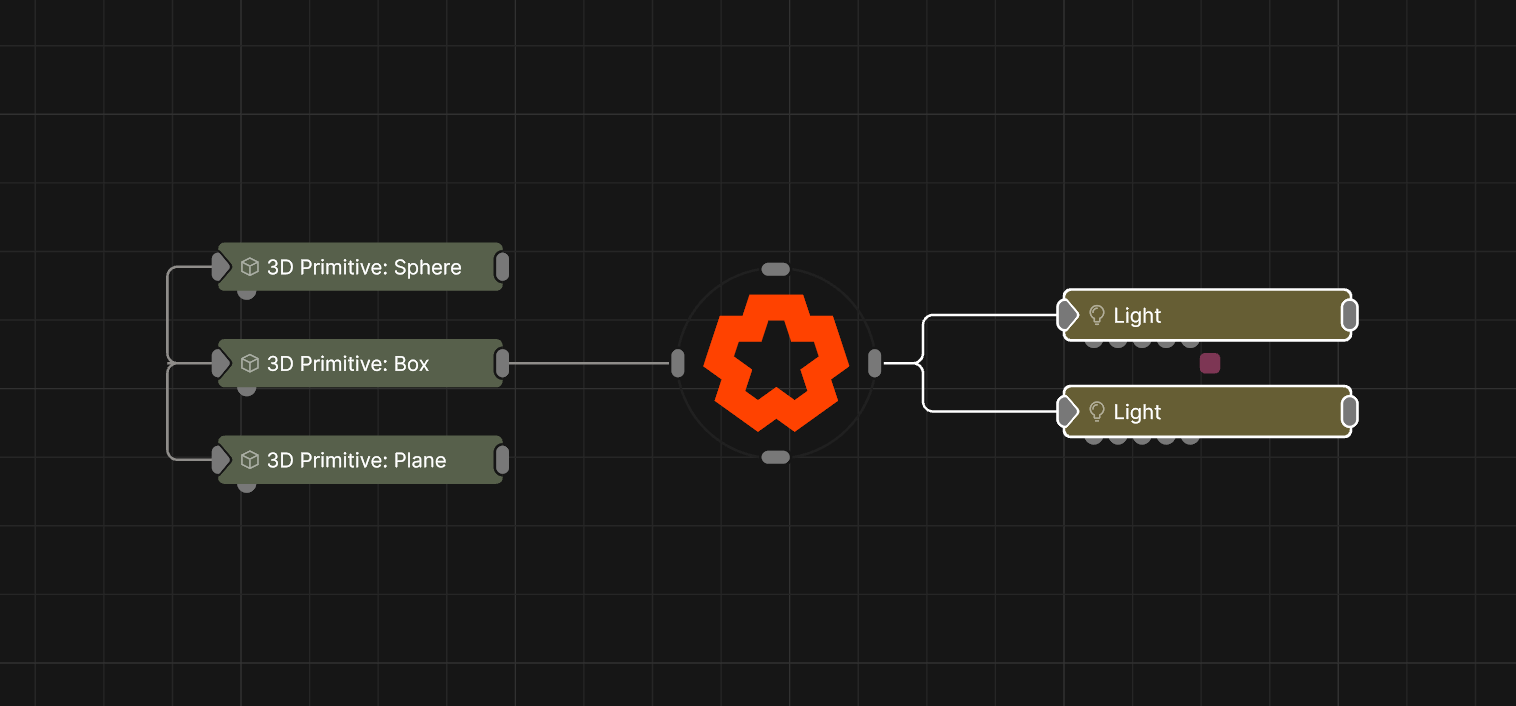

Add a Light node into the scene.
Attach the Target Node input to any object, to have the light track that object.
The default light node is a spotlight, in the node properties use the Light Type drop-down menu to toggle between Spot, Omni.
Light Type Choose which type of light is used in the scene.
  • Spot : light is emitted from a point within a restricted cone.
  • Omni : light is emitted in all directions from a point.
