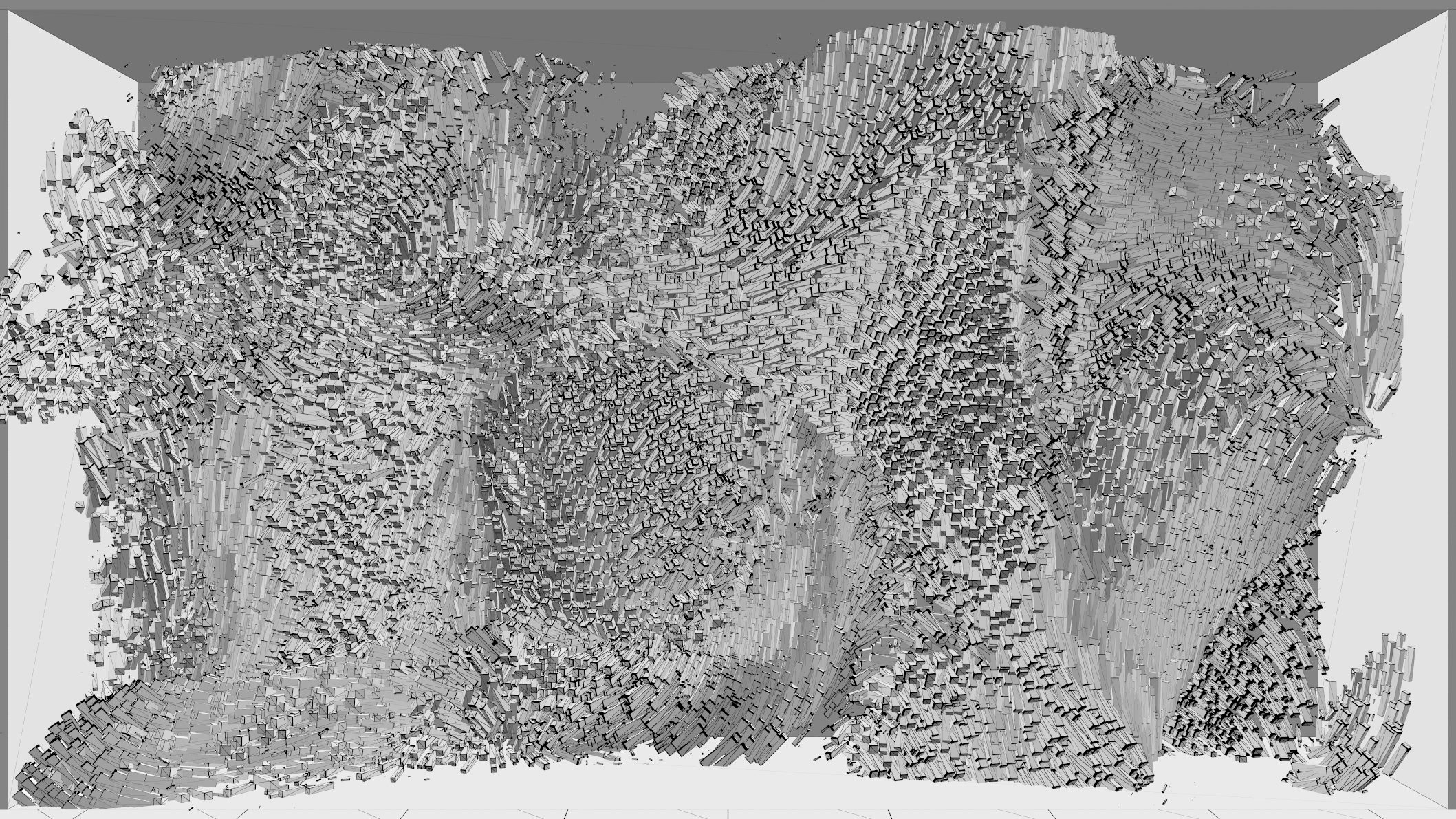

Wireframe #
Renders the scene as a wireframe. Helpful for getting an idea of the polygon density in a scene.
