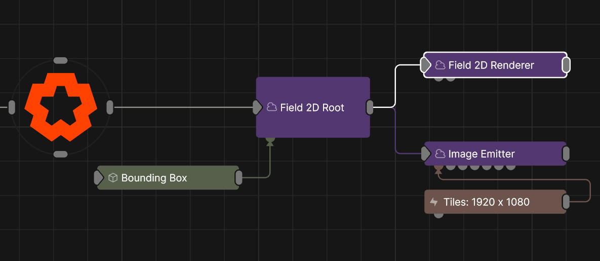

Renders a 2D field system as a 2D plane, which can then be composited with a larger scene. The node should be parented to a Field 2D Root node.
