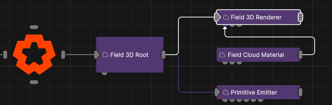

Renders a 3D field via path tracing.
Renders a 3D field via path tracing. A Field Material is necessary to control how the field is rendered and shaded.
Fields are rendered lit using the scene’s lights. The Affecting Lights and Excluded Lights can be used to control which lights are applied. If there are no lights in the scene the field will render black.
This node can also be used to visualise the field’s channels.
The node should be parented to a Field 3D Root node.
