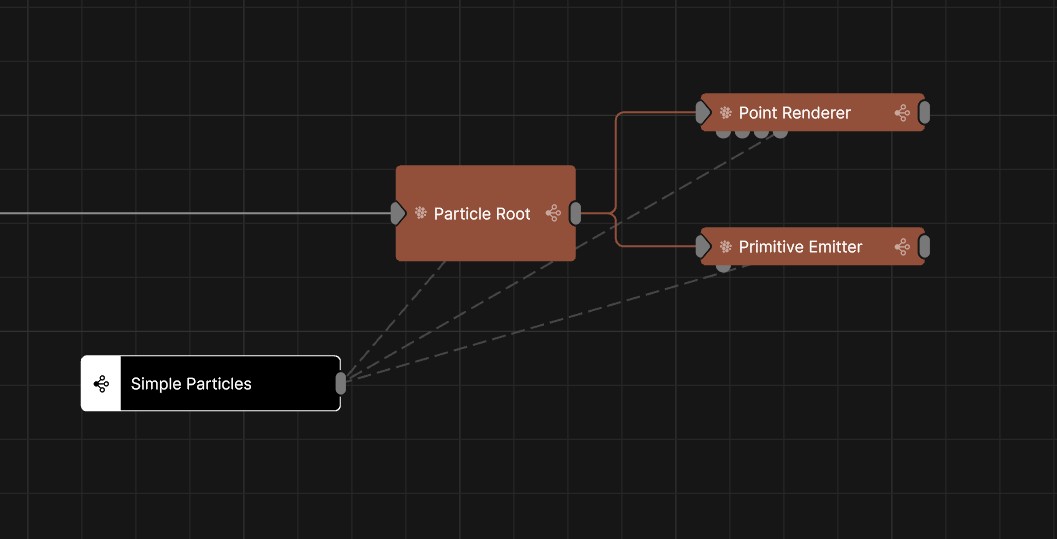

Selection sets allow you to quickly manage the selection of groups of nodes.Once a selection set has been created, double clicking on the selection set node will select all of the nodes that are inside of that selection set.
This can be really useful to build in to your project so that you can quickly select a group of nodes to make them available in the timeline or curve editor, to adjust their properties, or to re-organise your node graph.
There are two ways to create a selection set:
  • Use Ctrl + click or click and drag to select multiple nodes. Then right hand click inside of the node graph and choose “create selection set”. The selection set node will now appear on your node graph.
  • Add an empty selection set using the floating search with Ctl + Space, or from the Node List.
Once a selection set has been created, you can add nodes to the selection set by clicking and dragging from it’s output pin onto any node.
Holding shift while dragging from the output of any node allows you to make multiple connections at a time. Hold shift and click on multiple other pins.
To remove nodes from the selection set, select the selection set node, and then delete the links to other nodes with Ctrl + click.
You can re-name this node to give a descriptive name by clicking on it and hitting F5.
