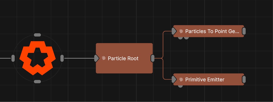

Emit particles from a primitive shape.
This node emits particles in the form of a 3D primitive shape. The Emitter Type parameter defines which shape is used. Particles can be emitted on the surface of the shape or inside the volume of the shape, depending on the Emit On Surface parameter.
If the emitter has an animated transform, emitted particles may track the motion of the primitive so they appear to stick to or follow the moving primitive. The Parent Transform Weight parameter scales this effect.
