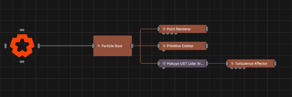

The output transform array may be used directly with a Array Cloner, or to clone other nodes within a Field System or Particle System.

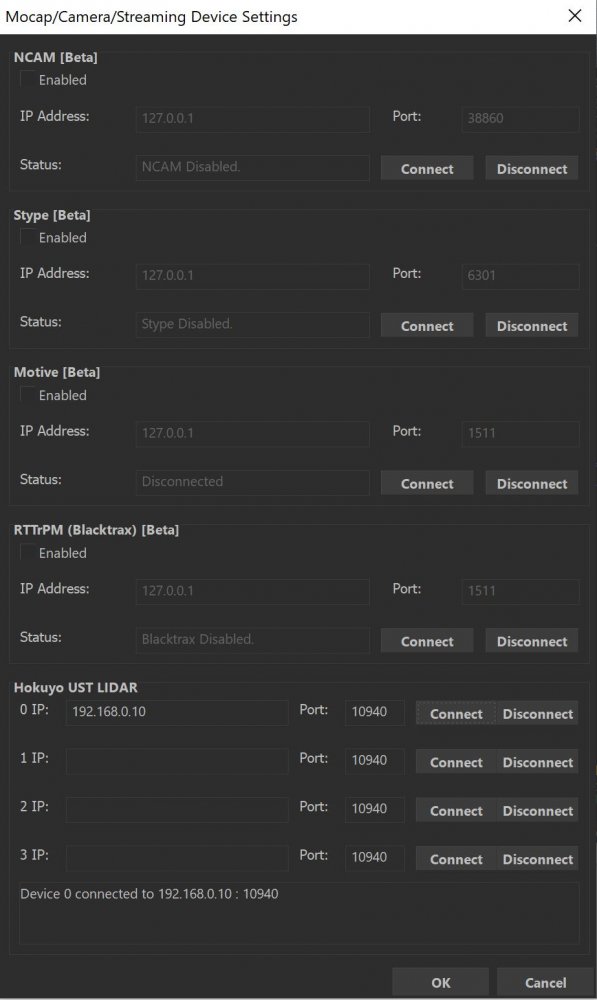

In Notch go to Devices->Mo-cap/Camera/Streaming Device Settings. At the bottom of the window is the Hokuyo settings, put the LiDAR IP address (192.168.0.10) and the port number is 10940. Press connect, You will see at the bottom of the window that the device is now connected.
Settings Example
The sensor will only accept one network connection, meaning only one PC/standalone/block/piece of software can talk to the sensor at a time.

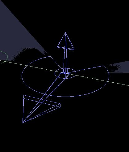

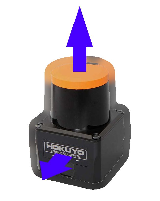

Once you’ve added the Hokuyo UST LiDAR node, you can see a wireframe visual representation of the sensor and its data by turning on the Bounding Box view. The arrows align as follows to the physical server. (Please note the black notch on the top of the sensor represents the ‘back’ of the sweep - i.e. the dead area).
When setting up the sensor, it’s useful to see the bounding box view while playing. To do this turn on View->Show Bounding Boxes and Range Finders while Playing.
The raw sensor data (represented by the blue lines) will only update while playing.
The representation of the arrows is demonstrated below.
Physical Orientation Notch Orientation
ust-10lx-transparent-arrows hokuyoboundingorientation
Use the arrows to match the orientation of the sensor to the real world. You can do this via the Transform Position & Rotation attributes and you can use the Sensor Rotation Offset attribute for fine-grain changes.

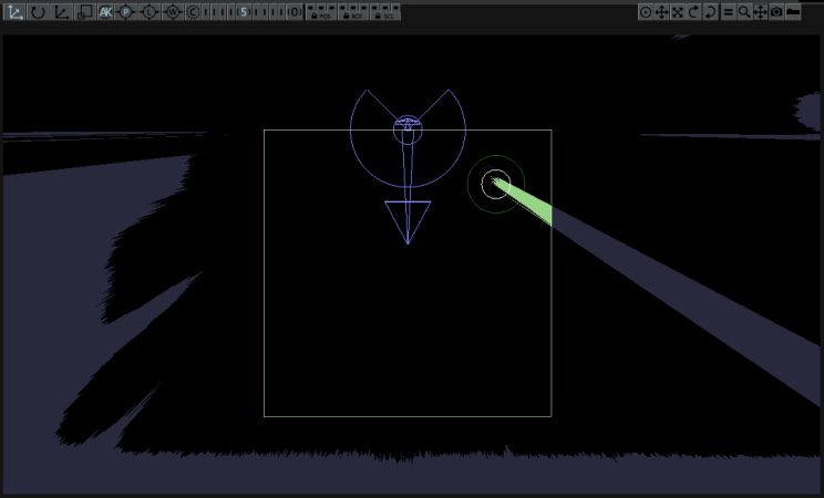

The region of interest is the area you actively want to track with the sensor, while excluding objects outside it. This could be the area of an LED screen, or the area of a floor. It is represented by the nodes green bounding box.
The sensor works in real metres. So when setting up your bounds, you’ll be working in metres. With Bounding Box visibility turned on, you will want to ‘find’ the active area. This is most easily done by placing people/objects/hands at each corner of the area of interest and then altering the Bounds: -X, +X, -Y, +Y attributes to find the edge of the subjects.
Bounding Box View
Where masses are seen within the region of interest (bounds), they will be analysed and a ‘point’ assigned to it and output within the Array. There are various attributes that can be used to fine-tune this analysis, but the default settings should work for detecting hands/wrists over surfaces >1m across.

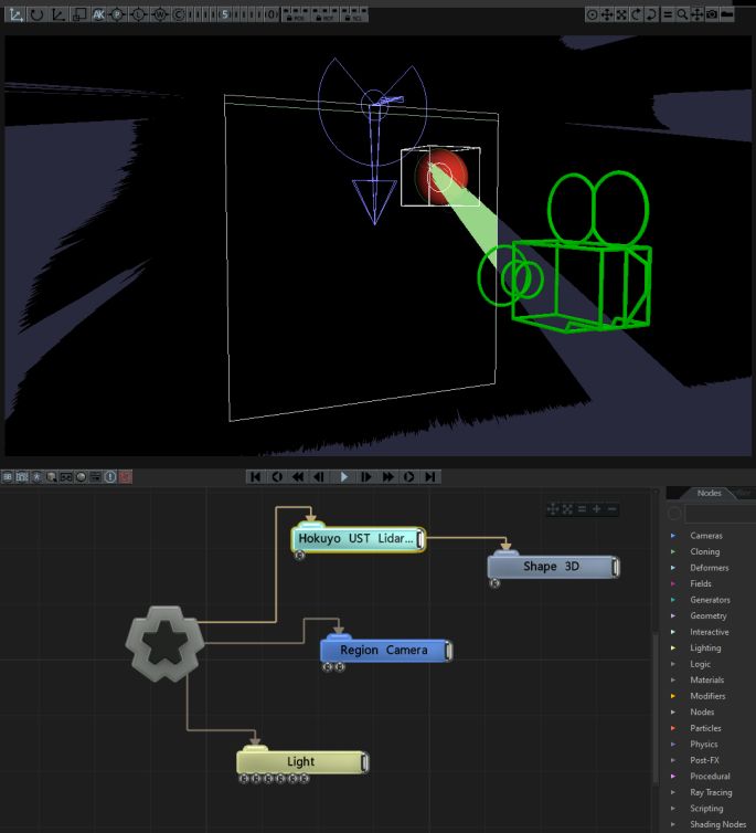

Example #
In this example, we have Shape 3D nodes being spawned where an object is found in the region of interest. We’ve also used a Region Camera to match the two spaces (both sensor and visual world together).
Nodegraph Example
