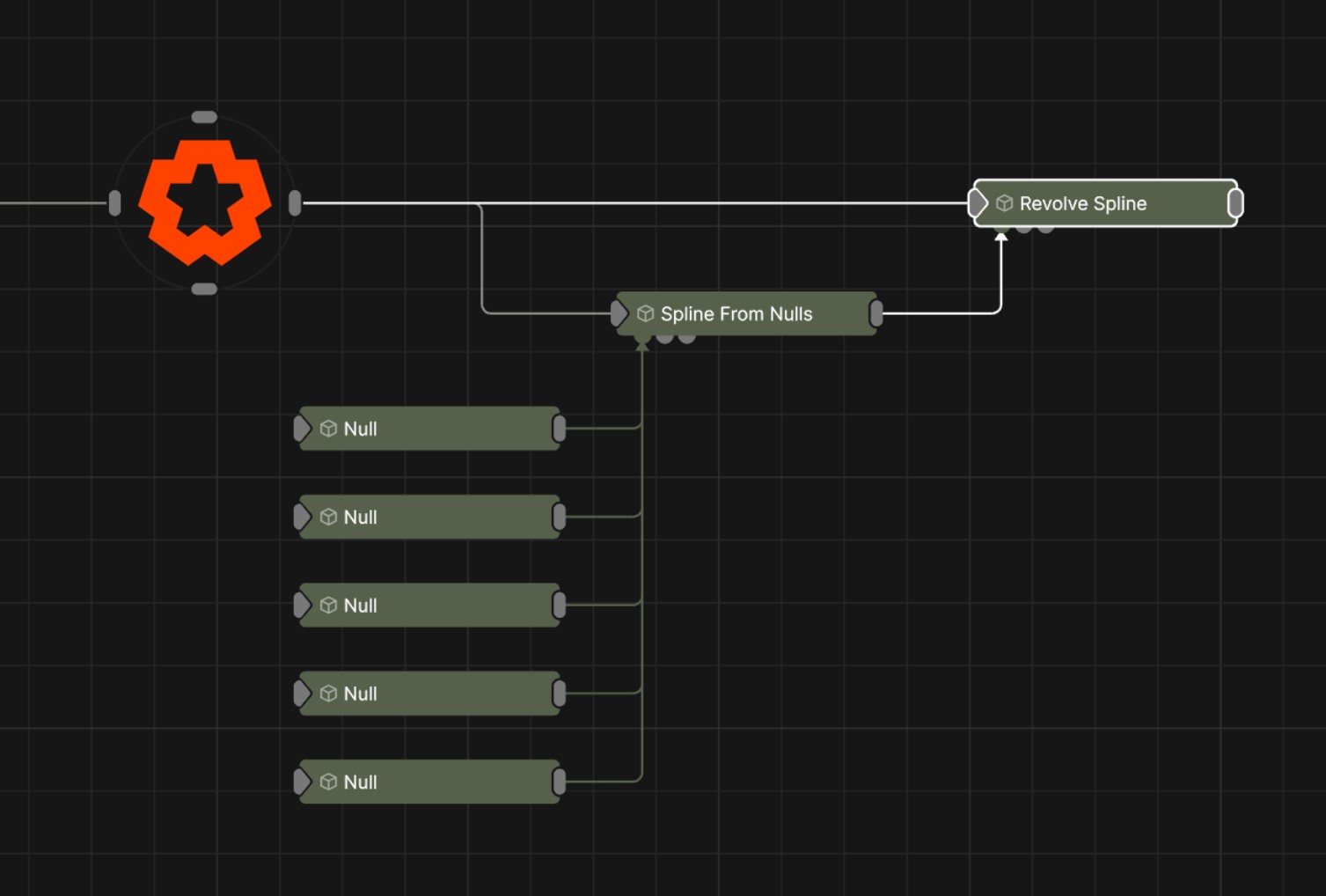

Revolve a spline to form a mesh
This node generates a mesh from an input spline curve, by following the path the spline would draw when rotated around a central axis. Useful for making vases, bowls, and other objects which are rotationally symmetrical.
A mesh can be used as input if it has the Object To Lines deformer. The Duplicate Splines deformer can also be used to easily draw multiple splines.
This node outputs the normal transformation and translation values, but it also outputs geometry which can be modified with Deformer nodes, or used as a mesh sources for nodes which accept mesh connections, such as the Field Mesh Emitter or the Procedural Mesh.
Edit Pivot TODO
Num Spline Segments How many subdivisiones are added along the spline length before being revolved. Higher values can improve the smoothness of the curve, but increase the geometry count significantly and therefore can impact performance.
Spline Time Min The start point of the revolved surface along the length of the spline, by a value normalised by the splines length.
Spline Time Max The end point of the revolved surface along the length of the spline, by a value normalised by the splines length.
Spline Time Offset Offset the generated surface before revolution, by a value normalised by the splines length. When used with the Spline Time Min and Spline Time Max, can form a slice which moves along the spline.
Num Radial Segments How many subdivisiones are added around the revolution axis. Higher values can improve the smoothness of the surface, but increase the geometry count significantly and therefore can impact performance.
Enable Thickness When enabled, extrudes the surface along its vertex normals, allowing for a bit of thickness across the revolved surface.
Thickness How thick the surface extrusion should be. Only available when Enable Thickness has been enabled.
Use Spline Colours When enabled, the extruded spline will apply the spline colours from the source spline to the revolved geometries vertex colours.
