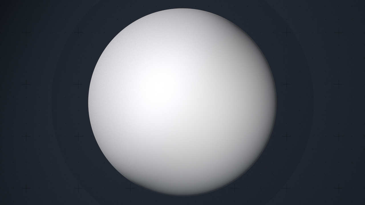

Diffuse alpha blended material containing captured shadows.
The Shadow Catcher node is intended for capturing and reusing shadow information as a material. It does not create, control, or affect the normal shadow rendering produced by lights in a scene.
The node records shadows cast onto a surface that has the Shadow Catcher material applied to it, and converts those shadows into a diffuse alpha-blended material output.
This material can then be composited onto other surfaces using layer blend modes and alpha channels. This is useful when shadows need to appear on surfaces that are not part of the rendered 3D scene, such as real-world floors or objects in AR applications.
The output material can be applied to any node which accepts a material input, such as 3D Objects, Particle Trails, or a Procedural Raytracer.
The shadow catcher node is great for adding shadows onto surfaces for AR projects.
