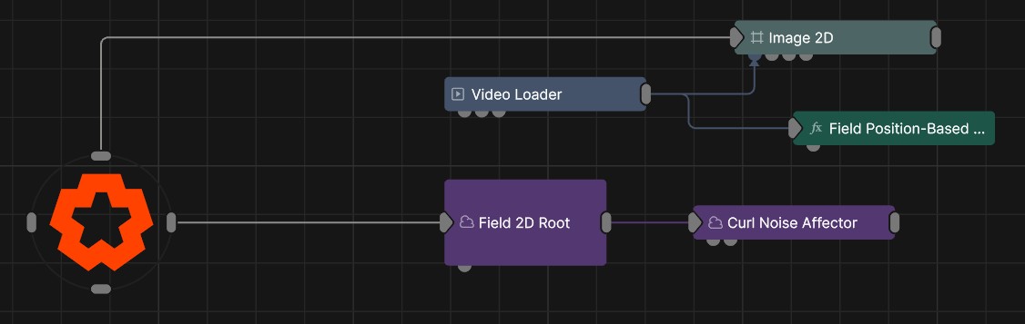

This node warps an image based on the movement vectors of an input field. The field movement vectors are used to deform a position lookup grid over time, which is then used to sample the image every frame. This allows animating deformations to be applied to separately animating sources.
The processed texture above has been altered from default to show the kind of effect you can get with this node. By default, no change will be made to the node until you input a field root system.

Source FieldInput a field root node to affect the image.Field 2D Root
