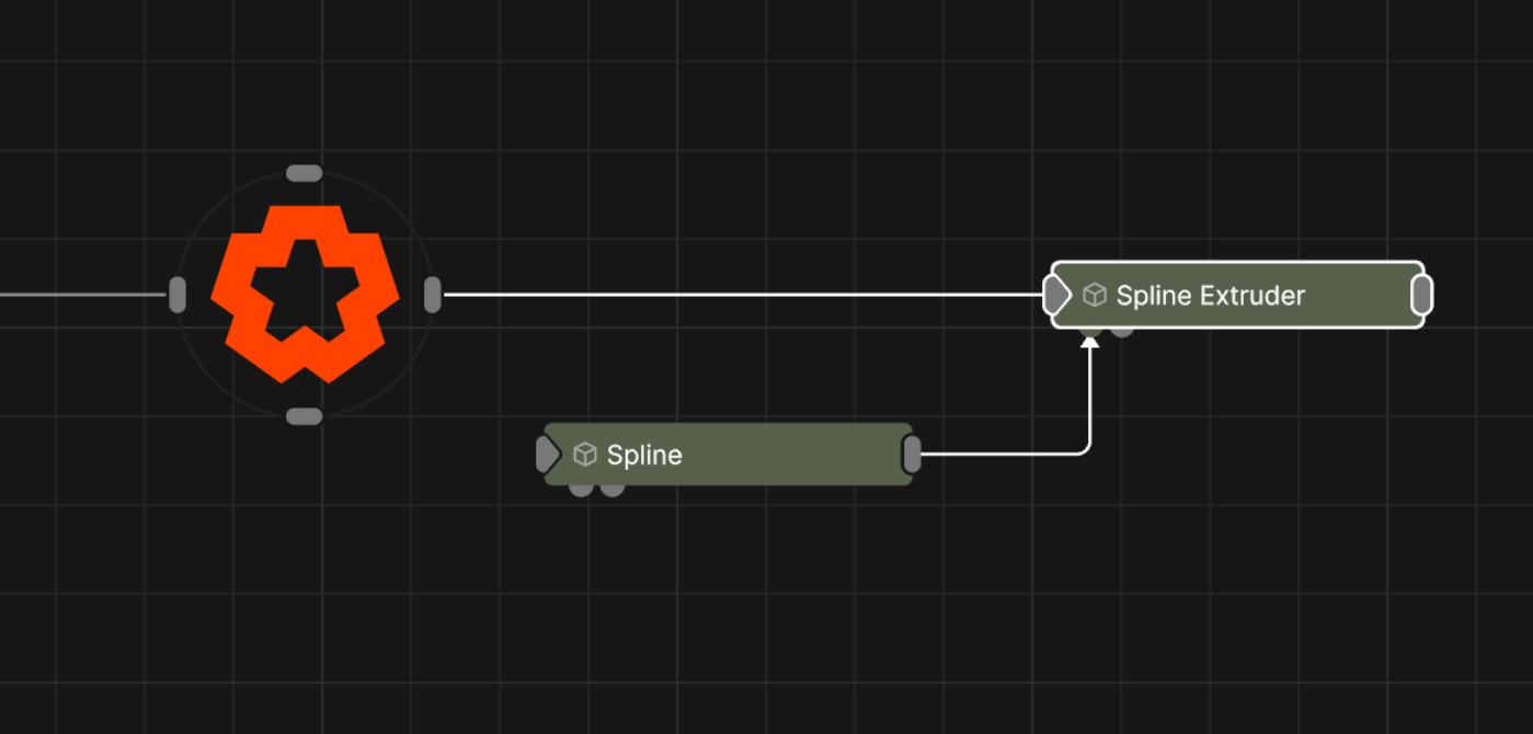

This node extrudes n-gon shapes along a spline.
This node generates a mesh from an input spline, by extruding a shape along the spline. The input spline can be modified via their control points, and the extruded mesh will dynamically update to match. Useful for making tubes and tunnels, as well as wires and ribbon effects.
A mesh can be used as input if it has the Object To Lines deformer. The Duplicate Spline deformer can also be used to easily draw multiple splines.
This node outputs the normal transformation and translation values, but it also outputs geometry which can be modified with Deformer nodes, or used as a mesh sources for nodes which accept mesh connections, such as the Field 3D Object Emitter or the Procedural 3D Object.

Spline SourcesSpline nodes used to draw the extrusion along.Spline
MaterialOverride the default material with a material node.Material
