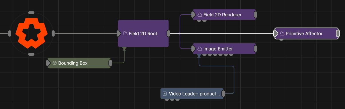

Use basic primitives to affect the field.
This node uses basic geometric shapes to affect the field, by attracting or repelling the ink with respect to the selected primitive surface.
