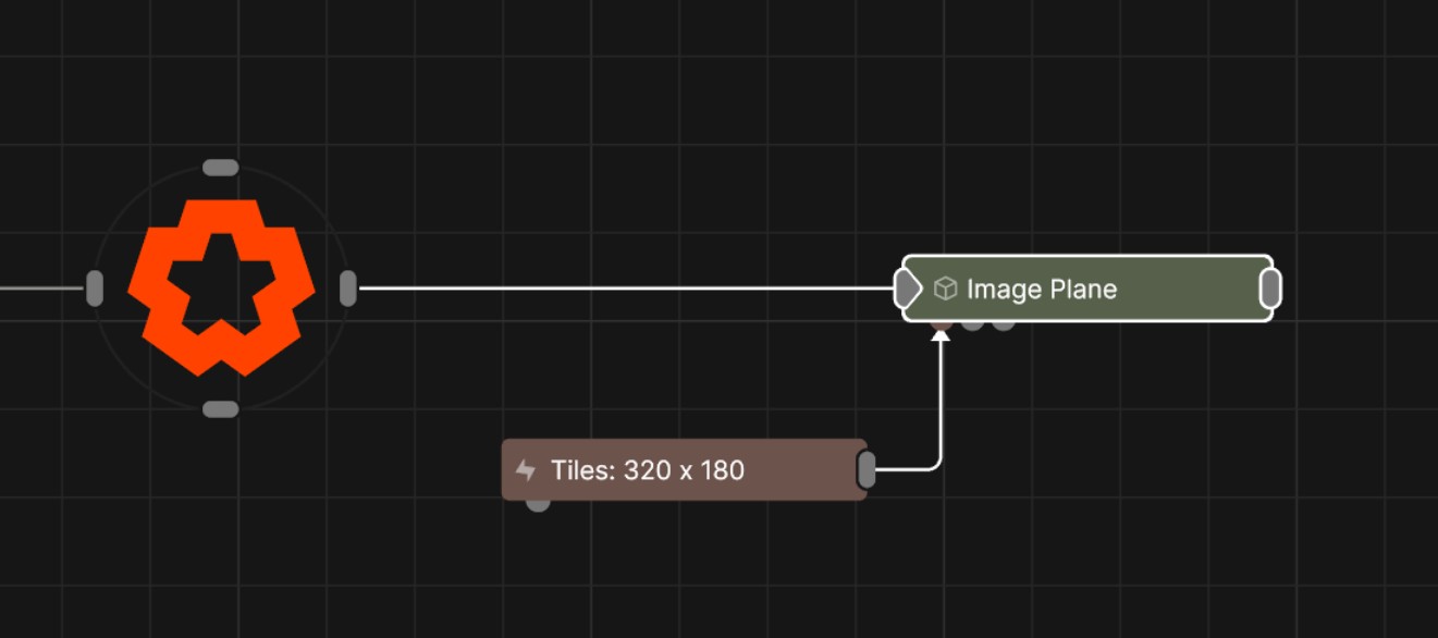

Render an image or video on a plane in 3D space.
This node is used to render an image or video on a plane in 3D space. The image may be set directly via the Image parameter or linked via the Video Node input.
Image Plane nodes have similar rendering options to other geometry nodes such as 3D Objects or 3D Primitive nodes.
This node outputs the normal transformation and translation values, but it also outputs A mapped texture which can be used on mask node inputs for Particle Emitters and Particle Affectors.
