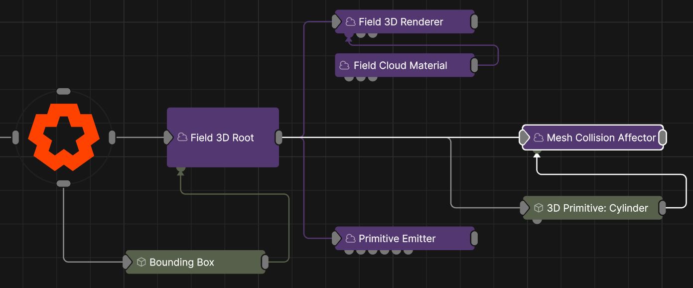

Allows fields to collide with 3D Meshes.
This node allows fields to collide with polygonal 3D objects. The field will flow around the object’s surface and be prevented from entering it.
Collision Velocity How much the field ink bounces off the colliding surface.
Invert Shape Invert the collision area, usually flipping the collisions from outside the mesh to inside the mesh.
ObjectInput an object for the field to collide with. A mesh must be connected to this input for this node to function.3D Object
