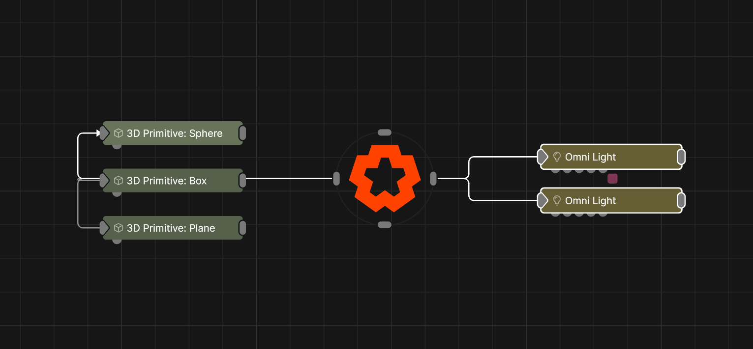

Adds an Omni Light node into the scene, which casts light in all directions around it.

Projection ImageDeprecated feature. Projection images should not be used with omni lights.Video Loader
Affected NodesChoose which nodes are affected by the light node. By default, all are affected.3D Object
Excluded NodesChoose which nodes are excluded from the light node. By default, none are ecluded.3D Object
Texture Projection NodeControls the direction the image is projected from, independant of the light. Only functions if an image is being projected from the light.Null
