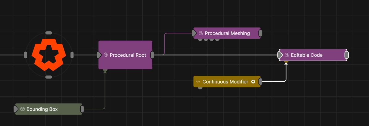

Generates a shape for a procedural system from custom code.
This node allows a custom piece of HLSL code to be written to produce a distance value from which a procedural shape will be created. For best results with this node you should have a working knowledge of the HLSL shading language, and signed distance fields.
IMPORTANT: The custom code is inserted into a larger HLSL function, and therefore creating functions is not supported.
