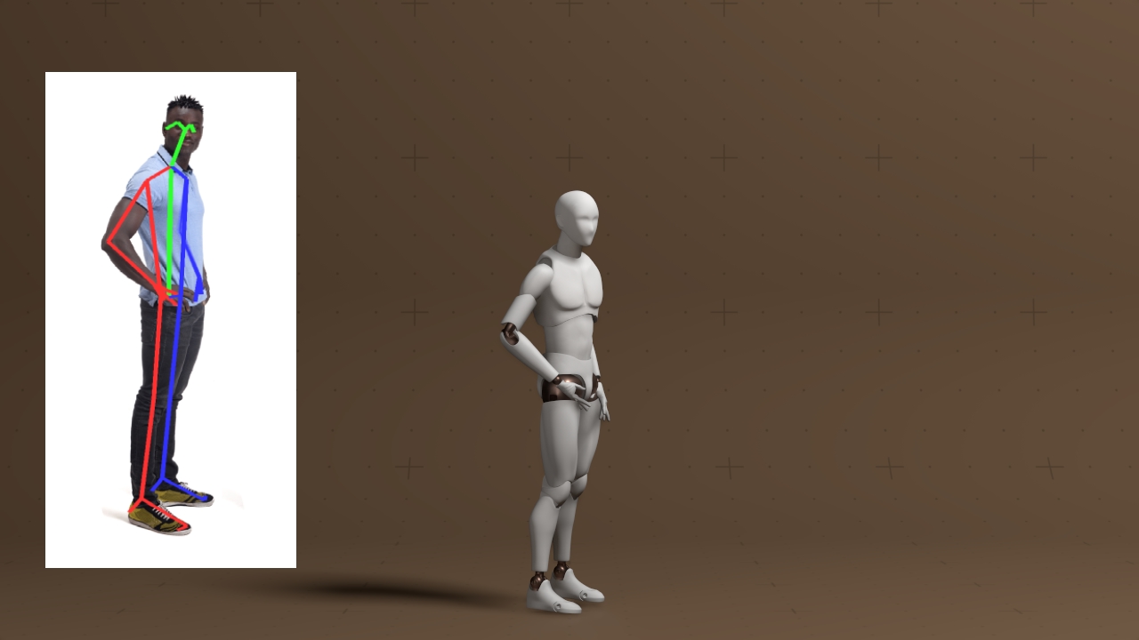

This node applies the tracked skeleton from the NVIDIA AR Body Tracker to the skeleton of a connected rigged character.
This node requires the installation of the NVIDIA AR SDK, which can be downloaded here : NVIDIA AR SDK. Make sure you get the correct driver for your GPU, Turing (20XX), Ampere (30XX) and Ada (40XX) use different drivers and they are not cross compatible.
For best results, use a character with a rig generated from Mixamo. Other skeletons can be used, but results may vary.

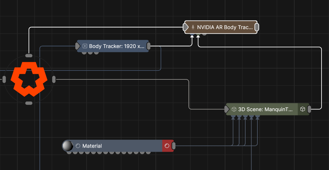

| Input Skeleton Scale | Scale the size of the input skeleton. |
| Smoothing | How much smoothing is applied to the output skeletons motion. |
| Mirrored | Mirror the movements of the incoming mobcap data along the x axis. |
| Flip Z | Flip the Z axis of the skeleton, to match a model with a flipped z axis. |
| Tracking Confidence Threshold | Threshold for how confident the tracking data needs to be before applying to the skeleton rig. |
| Parameter | Details |
| Duration |
| NVIDIA AR Video Body Tracker | The video stream from an NVIDIA AR body tracker to derive the skeleton from. | Video |
| Hierarchy Root | Connect the skeleton root node to drive the rest of the skeleton from. | 3D Scene |
