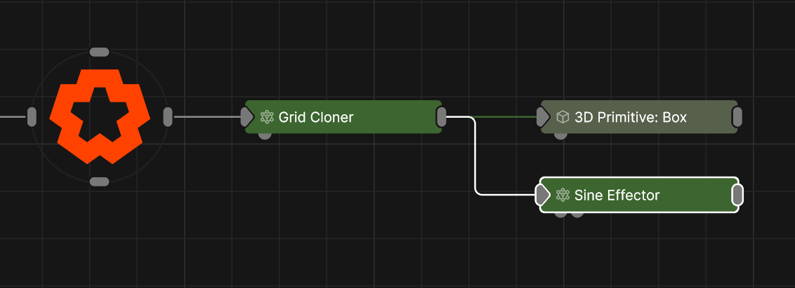

Modifies a cloner system with sine wave oscillations.
This node applies a transform to every clone using a sine wave as a source. Various properties can modify the sine waves speed and scale, or even direction it applies through.
