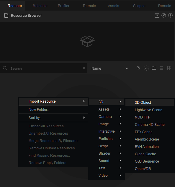

  • Drag and drop from file explorer directly into the nodegraph. This will create a new node on the nodegraph and add the file to your Resource Browser
  • Right click in your resource browser and choose “Import → 3D” from the menu. This will add the 3D file to your resource browser. From there you can drag it out onto your nodegraph.
  • Choose “Import” form the file menu in the top left of the programme. This will also add your chosen file to the resource browser.

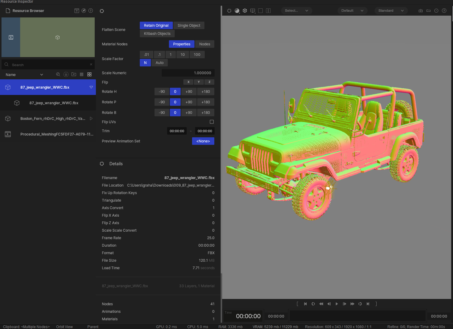

Notch 1.0 Introduced the Inspector window. This window allows you to view, manage and manipulate all of your resources, from videos to geometry.
Changes made here will affect your 3D resource on a resource level. this means that if you adjust something here, for example scale, the scale change will be applied to every instance in your project where that 3D object is used. This is really handy for ensuring a model has imported correctly before using it. See the next section on Geometry Nodes to apply changes to an individual instance of an imported resource.
You can use the resource browser to do several functions to manage your imported geometry:
  • Flatten a 3D scene made of similar objects into one object, or ensure it is treated as a kitbash object. This is a really important and useful function to keep in mind when working with complex 3D scenes. Flattening the resource will ensure that it is treated as one object in Notch, which can massively improve performances compared to objects made of large numbers of parts.
  • Determine how it’s materials are applied. Applying materials as “nodes” will create a node for each material included in your 3D scene. This is useful if you are going to swap or alter the materials of teh object. Applying materials in “properties” will not create nodes, and instead will apply the materials via the properties on the 3D scene node. This is is more performant if you are not looking to alter the materials at all.
  • Scaling the object on a global level. This will scale all instances fo the object across your entire project.
  • Adjusting co-ordinate space. Use this to alter the co-ordinate space on import.
  • Rotating the object.
  • Flipping UVs. This flips the UVs of the object in the V axis.
  • Managing the 3D objects timeline. Trim the start and end time of the object;s timeline.

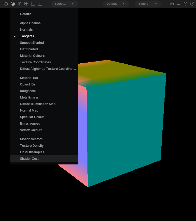

Another useful feature of the Inspector is that it gives you views to check other aspects of your imported file.
Form the drop down menu in the top of the Inspector’s viewport, you can review normals, tangents, material IDs, object IDs and more.
