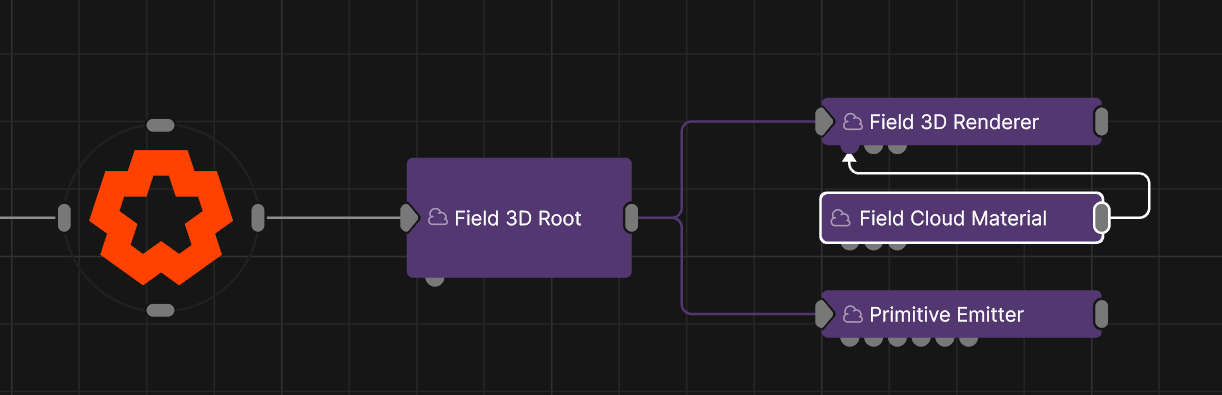

A 3D field material suitable for smoke and cloud volumes, which shades solely based on density.
A 3D field material suitable for smoke and cloud volumes, which shades solely based on density. The Scattering parameter is used to control the ratio of scattering vs absorption. Clouds have high scattering, low absorption; smoke has low scattering and high absorption.
