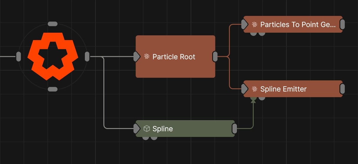

Emits particles from a spline.
This node emits particles from a spline shape. The splines used by this node are extracted from a 3D object which must be connected to the Object Nodes input for this node to have an effect. If The object that is connected contains no spline data this node will have no effect.
Requires a Spline input to function.

Spline NodeThe spline to emit from.Spline
