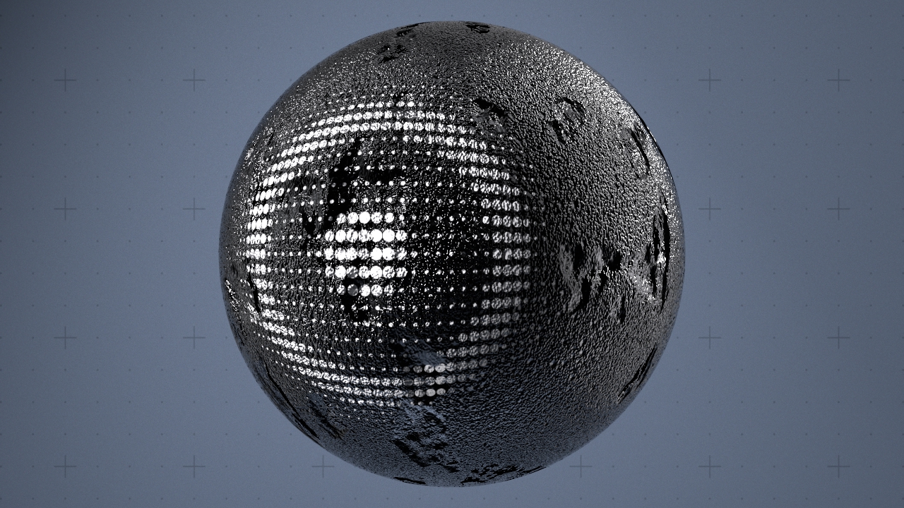

Add decals to surfaces in the scene
This node projects images directly onto surfaces within a 3D environment. Instead of altering the original texture, the decal “layers” over it, allowing you to add visual effects like dirt marks, graffiti, impact marks, or other details. This approach makes adding visual details more flexible and resource-efficient, as it avoids the need to recreate or overload the original textures for each new visual addition.
