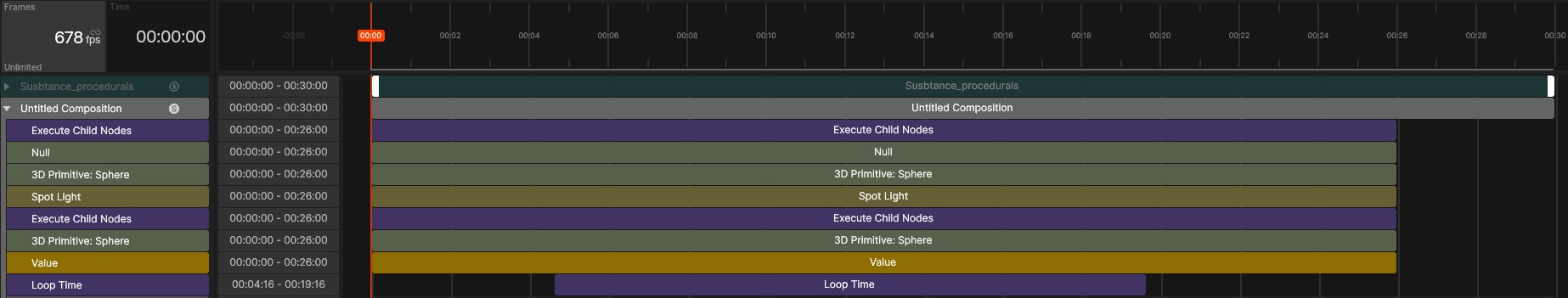

Set a loop section in the timeline.
This node allows you to set loop sections in either your current layer or globally. A loop section is an area of the timeline that you wish to repeat. Setting the Loop Time nodes start and end time, will define the loop section.

The Layer mode is used when you are running your project layers in compositing mode (i.e. Have not set Layers as Separate Effects in Project->Settings).
