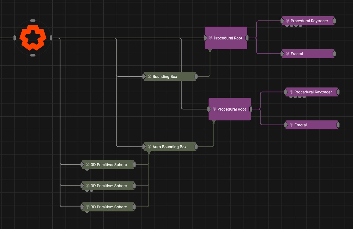

This is done by using the Procedural Root. The position and scale of the Procedural Root will define where the procedural system will be calculated. This can be done in two ways:
  • By using the position, size and scale properties on the Procedural Root node.
  • By using the Bounding Box input to the Procedural Root node. In this case, the position and size of the procedural system will be defined by the input from a Bounding Box node.
The Auto Bounding Box node generates a bounding box based on the combined size of nodes input. This can be a useful alternative for setting up a Bounding Box automaticaly

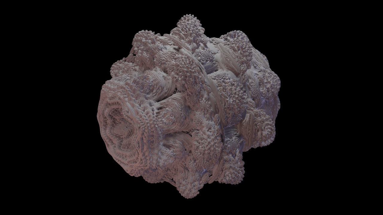

Any procedural nodes that are attached the Procedural Root node, but positioned outside of the bounds of the Procedural system, will have no effect on the Procedural system. They will be ignored in all calculations of the SDF.

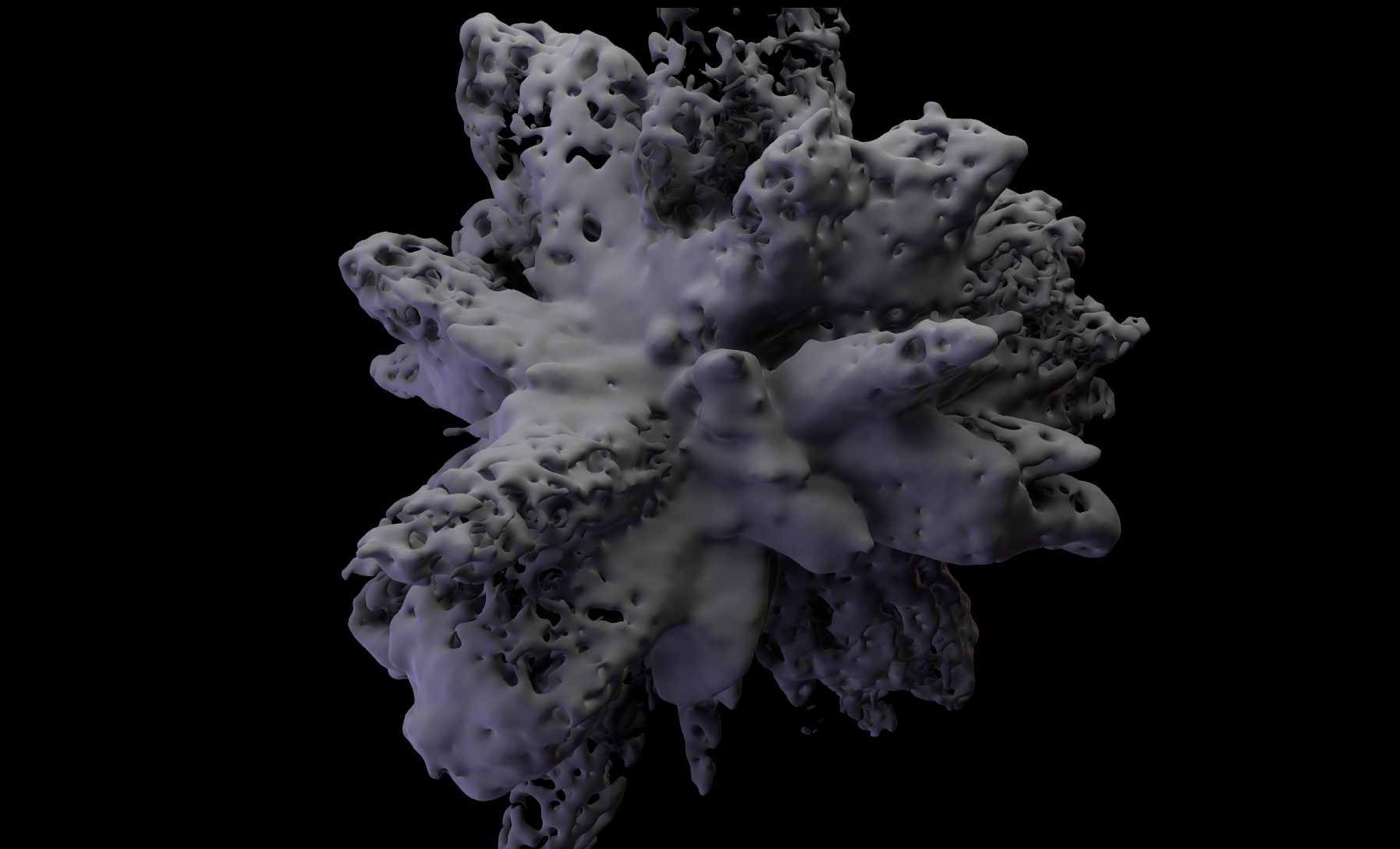

raytraced fractal

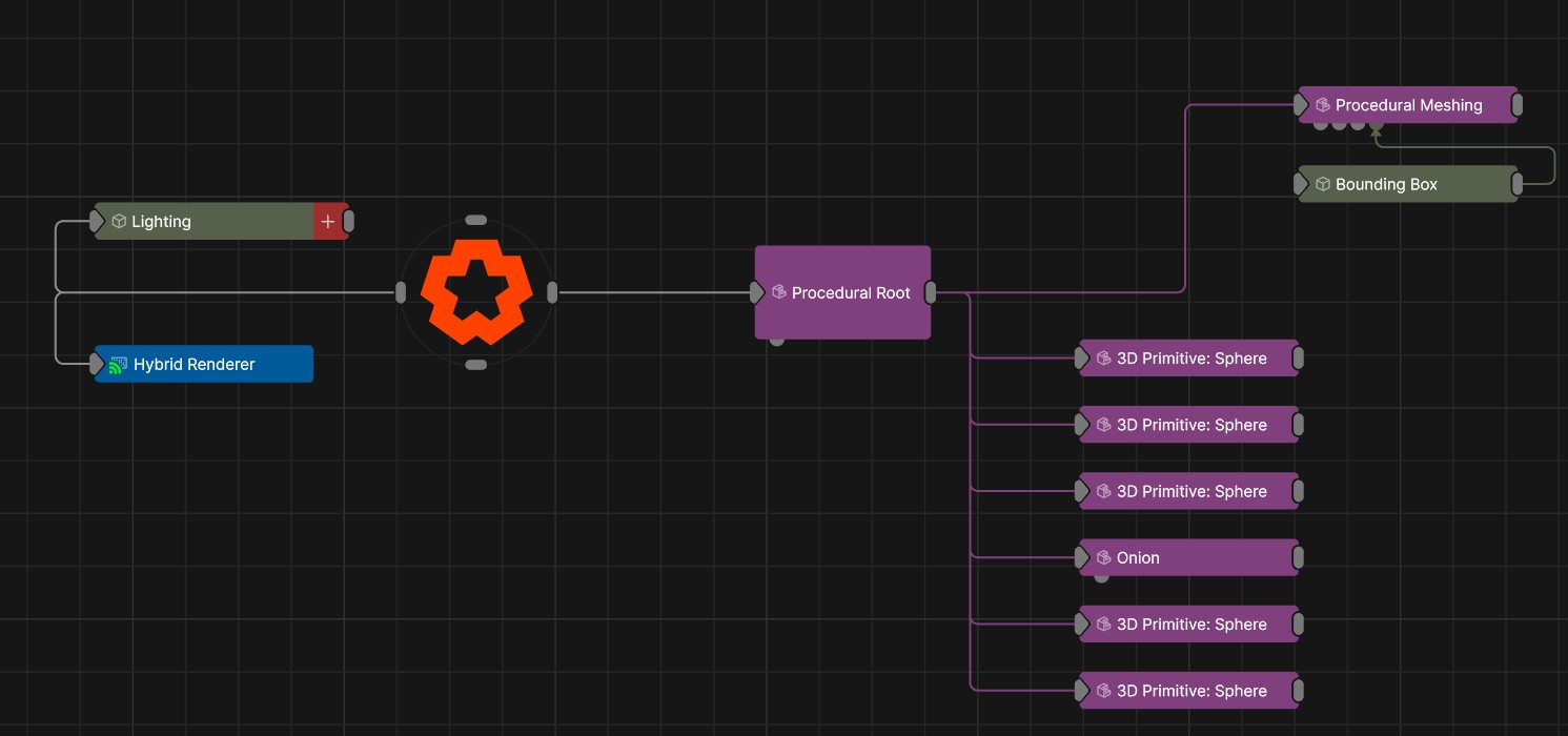

bounding box setup

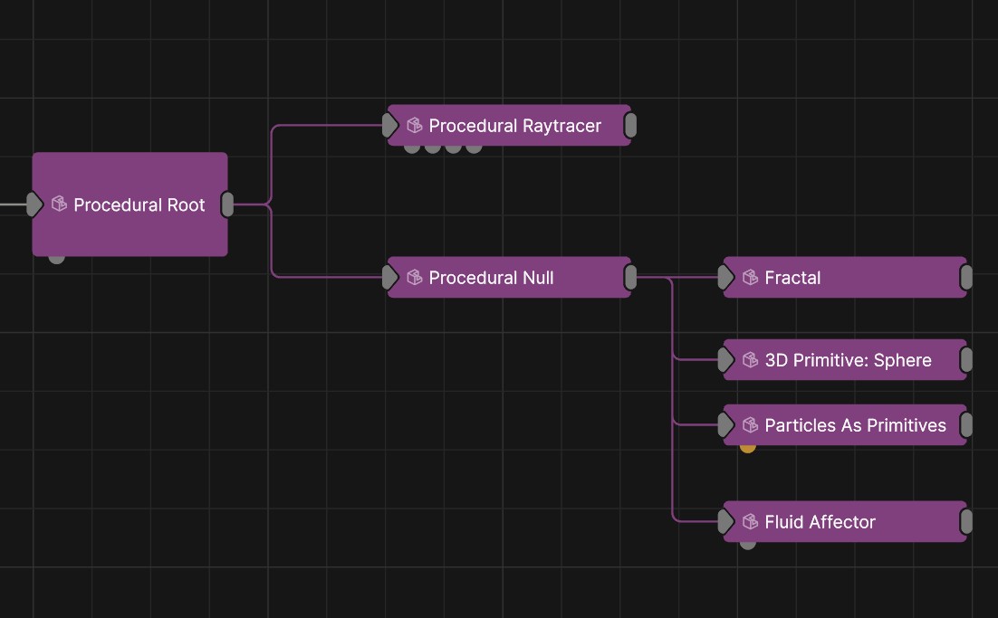

While not strictly a generator, a related utility node that can be very handy in combination with Generator nodes is the Procedural Null. This node combine multiple generators together before adding them to a Procedural system. An generators that are parented to the Procedural Null will be combined and treated as one system.
procedural null
combining geberators

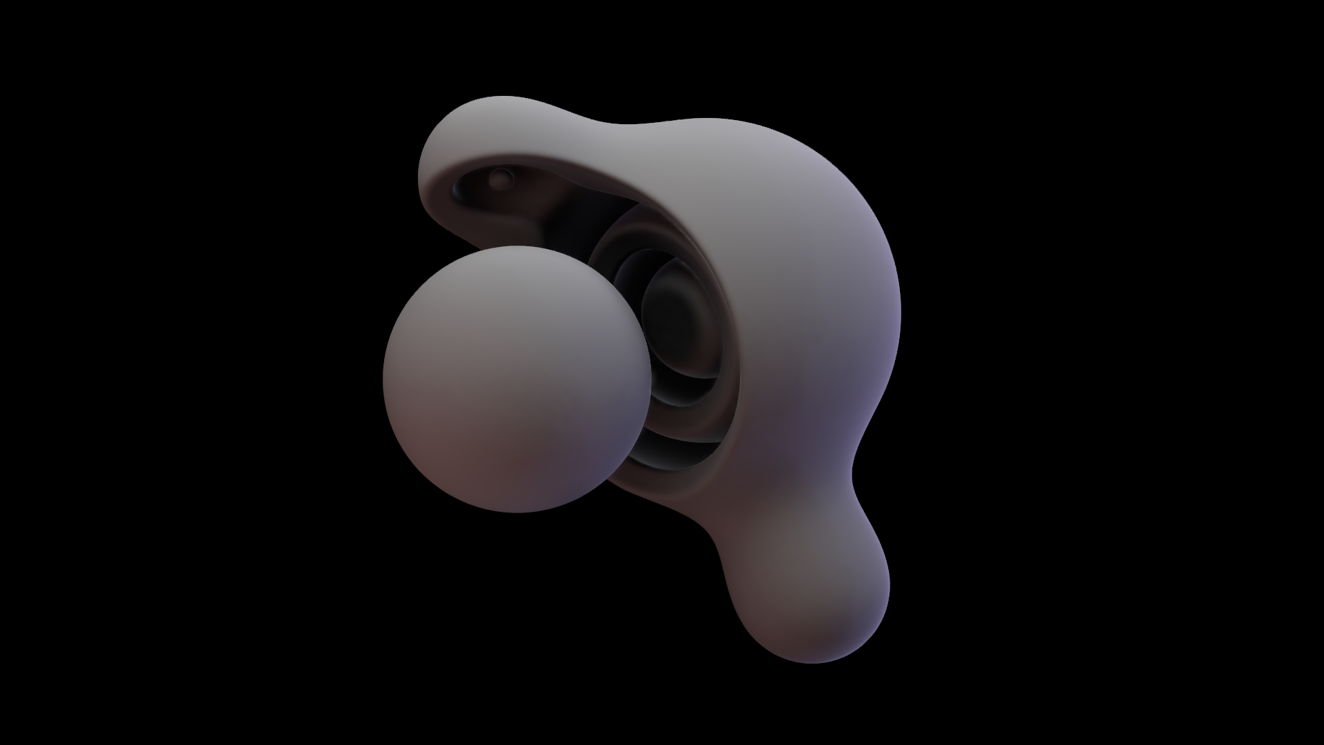

raytraced fractal

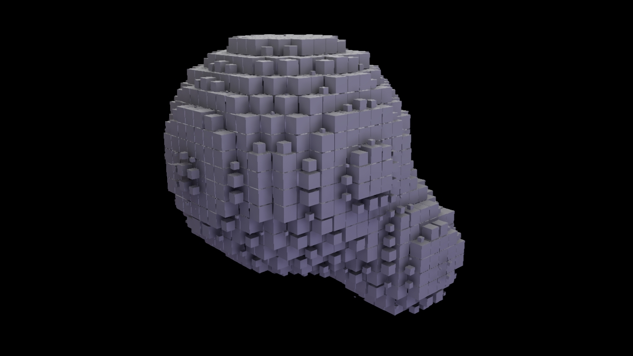

bounding box setup

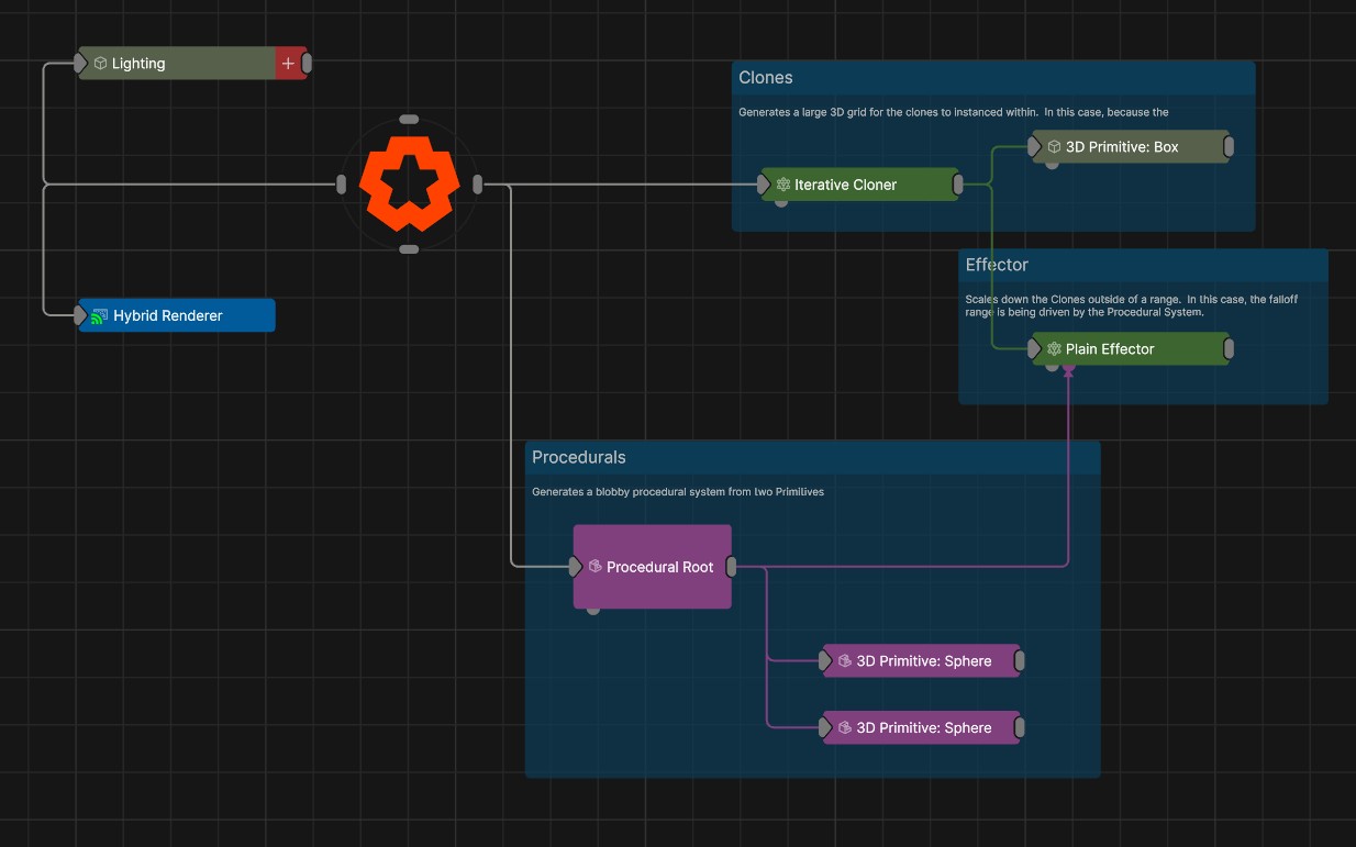

procedural falloffs on clones
falloff setup
