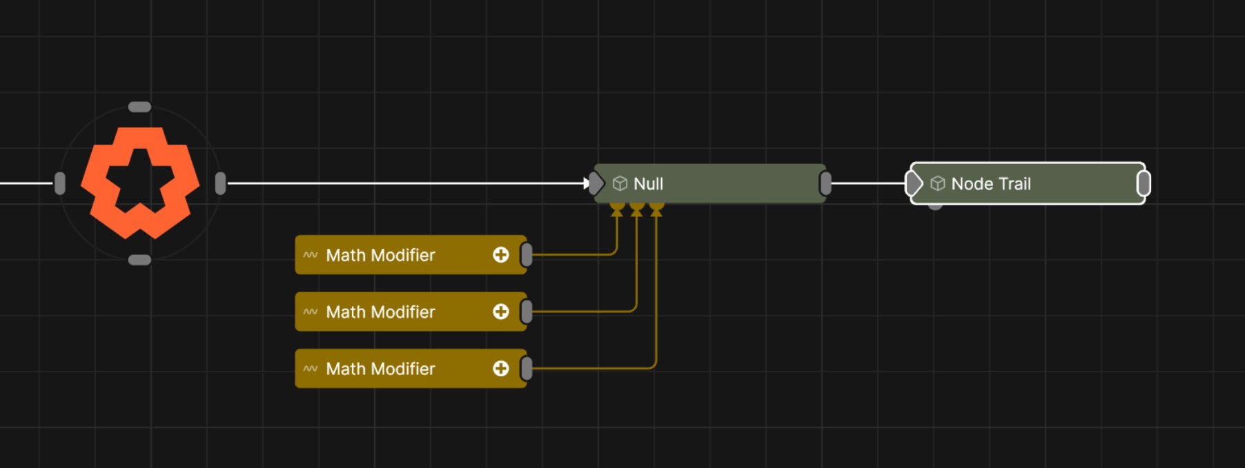

Creates a spline that follows a node.
This node creates a spline that follows the position of a node in the scene. At each frame update, a new point is added to the spline, continuing to grow the splines length. no smoothing is applied to the spline, so large positional changes or erratic motion can appear noisy.
This node outputs a spline which can be input into other nodes which use splines to generate new effects, such as the Spline Extruder or the Particle Spline Emitter.

Trail Source NodeWhich node to follow when drawing the spline.Null
