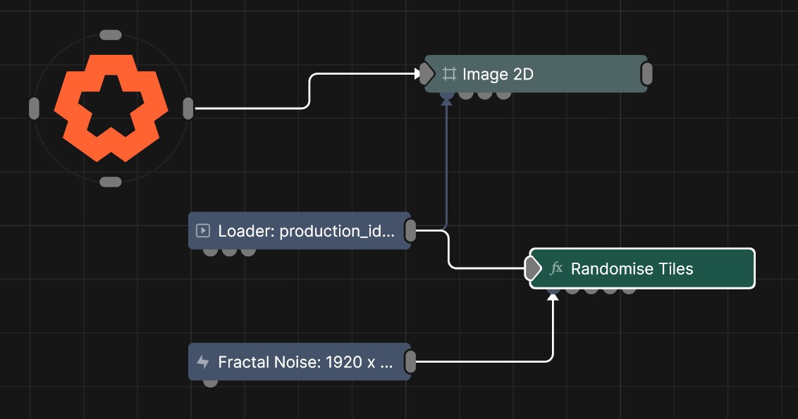

Randomise Tiles
Randomise parts of the image based on an input image.
This node breaks the image into a grid, and randomises the positions and frame delays of parts of the image based on an input image.
The processed texture above has been altered from default to show the kind of effect you can get with this node. By default, no change will be made to the node until you input an image.

| Randomisation X Image | Randomise the image along the x axis based on the luminance values from an input image. | Video Loader |
| Randomisation Y Image | Randomise the image along the y axis based on the luminance values from an input image. | Video Loader |
| Delay Offset Image | Randomise the frame delay per tile based on the luminance values from an input image. | Video Loader |
| Image Sources | The images used to fill the random tiles. | Video Loader |
| Frame Delay Node | Input a video to use to define the delay amount for each tile.. | Video Loader |
