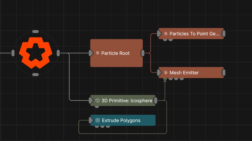

Emit particles from a mesh.
This node emits particles from a 3D mesh. The mesh must be connected via the “Object Nodes” input, and can be a 3D Object node, a Shape 3D node, a Text node or a Depth Camera / Kinect Mesh. If no suitable node is connected then no emission will occur. Deforming and animating objects are supported. The node chooses locations on the mesh to emit from in one of several ways depending on the Spawn Mode attribute. The vertices of the mesh can be used directly, or random points spread evenly across the polygon surface or the edges of the mesh can be used.
The mesh emitter can only be used by one material at a time, if you have more than one material you will need to bake the textures together.
