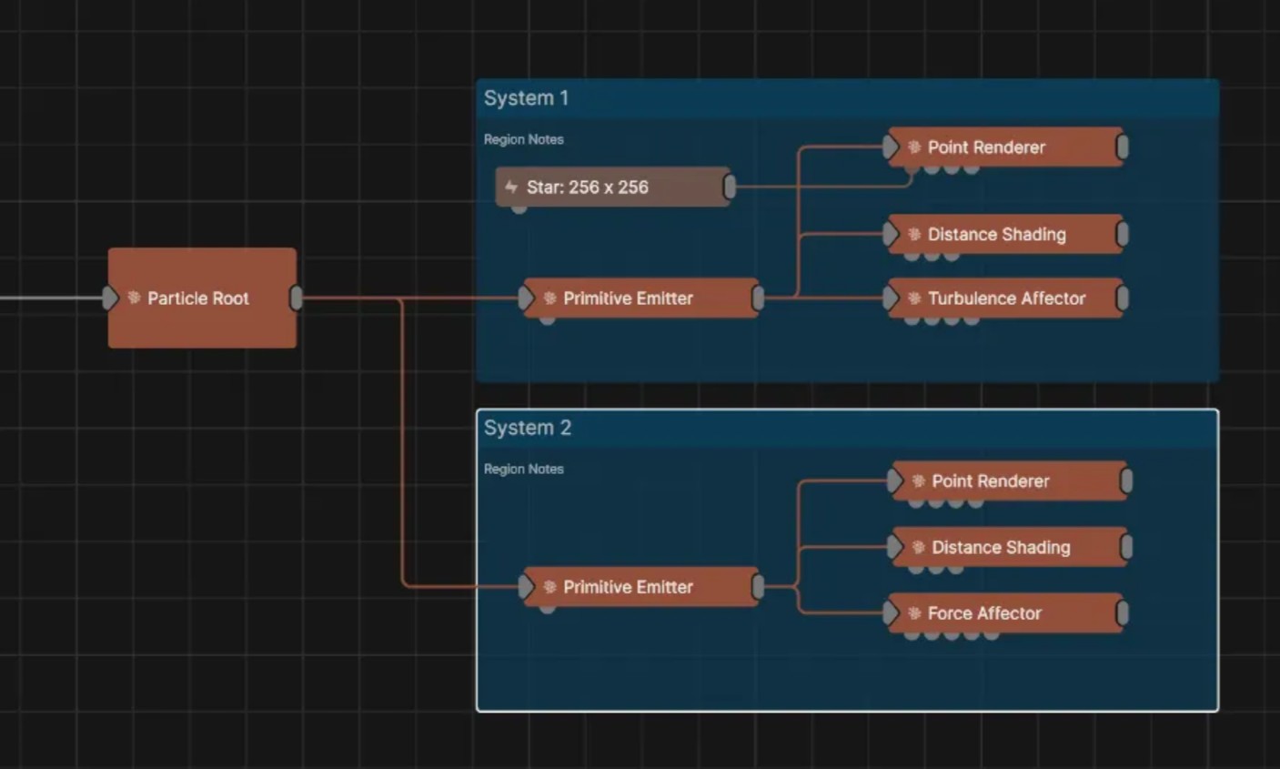

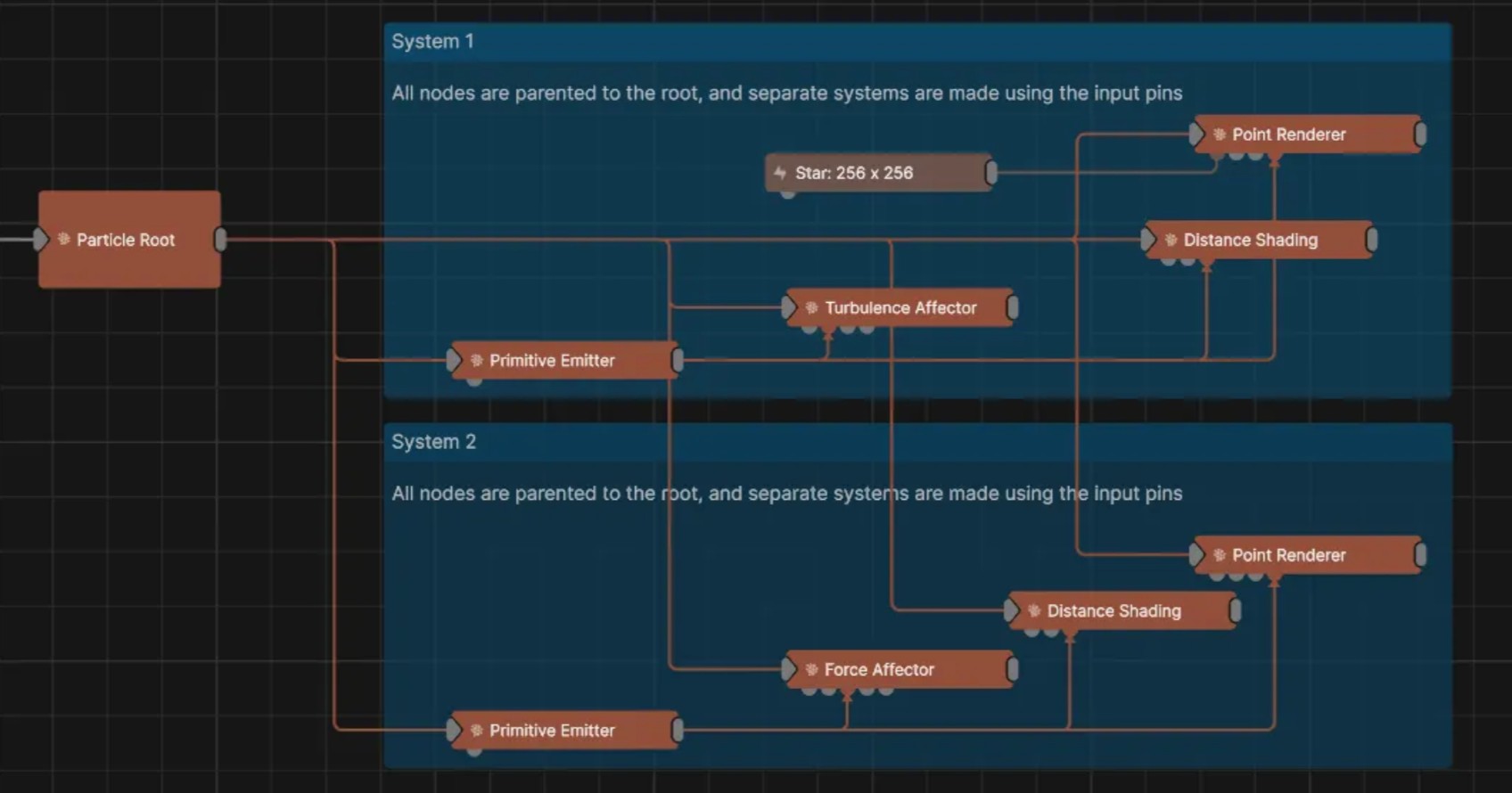

One Root, Multiple Systems #
When making multiple particle systems, it can be tempting to create a new particle root, emitter, renderer and affector(s) for every separate type of particle you want to render. While that is totally possible, it is not ideal. A better approach to building multiple particle systems is to keep everything under one particle root node, and build multiple systems within it. This has the advantages that:
  • When you add a Particle Root node to your node graph and set the maximum number of particles, Notch is allocating resources to handle your particle system. By just doing this just once, you will can optimise performance compared to using multiple root nodes.
  • Working under one root, all your particles are now connected in one over-arching system. As you’re working like this, any time that you decide you want two different particle emitters to interact, they can do. Say for example you wanted to add some physics, and have your particles from two different emitters bounce off one another. You can do this by adding the Particle-Particle Collision Affector. This wouldn’t be possible if you’re emitters were connected to two different root nodes.
There is a few features that can help you create multiple particle systems under one root:
  • Parenting renderers, shaders and affectors to a particle emitter will ensure that those nodes only apply to the particles of that emitter only.
One Root 1
  • Using the “Affected Emitters” (for shading nodes and affectors) or “Rendered Emitters” (for rending nodes) ensure that those nodes only apply to the specified emitter. This is done by dragging the output pin of the emitter to the relevant input pin of the other nodes.
One Root 2

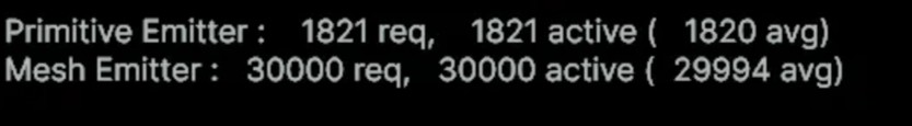

Metrics #
The Particle Root node contains a property called “Show Metrics”. Enabling this will bring up a text overlay on your viewport that shows you how many particles are present in each emitter at time. If you’re ever experiencing issues with particles not spawning when you expect them to, it’s pretty likely that you’re hitting the limits of your maximum numbers of particles without realising. Once an emitter has hit it’s maximum particle count, it will stop emitting.
Looking at the cold hard numbers can be a good way of getting a better idea of what is happening with your particle counts in each emitter and resolving issues.
Enable Metrics
Example Metrics

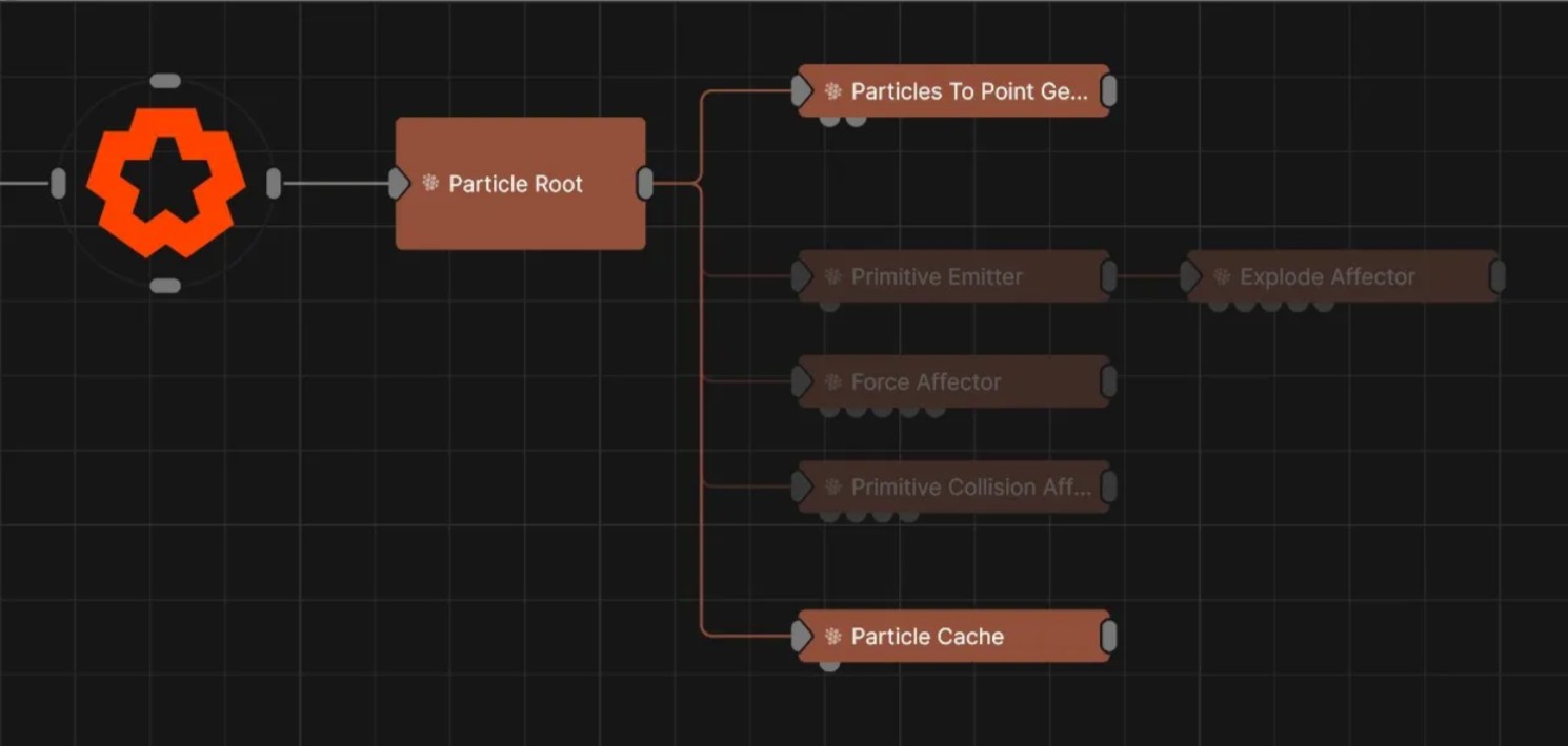

Caching Particles #
The Particle Cache Node deserves it’s own callout. You can find it under the emitter’s category, but it’s a got it’s own special functionality.
The particle cache node allows you to store the animation of particles to disk, essentially recording the output of all emitters and affectors. This allows them to be scrubbed in time and played back rather than simulated during playback. Particle cache files may be very large on disk. When the baking is finished, you can disable the other particle emitters / affectors, as they no longer contribute to the scene.
Caching Particles

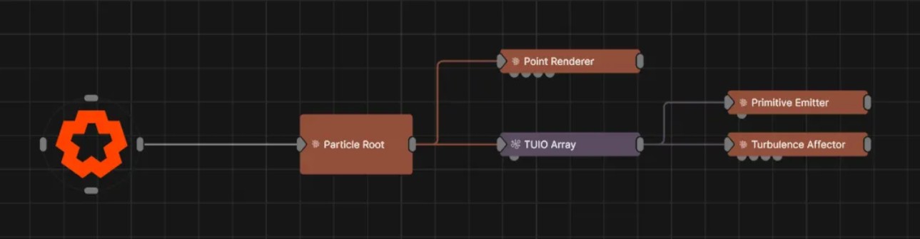

Using Arrays for Interactivity #
Particle Nodes can be created and moved using data coming form any of Notch’s Array Nodes. This simple setup let’s you create an emitter and an affector at each incoming position from the TUIO Array. Once you start expanding on this, you can make some really interesting interactivity really quickly.
Arrays and Interactivity

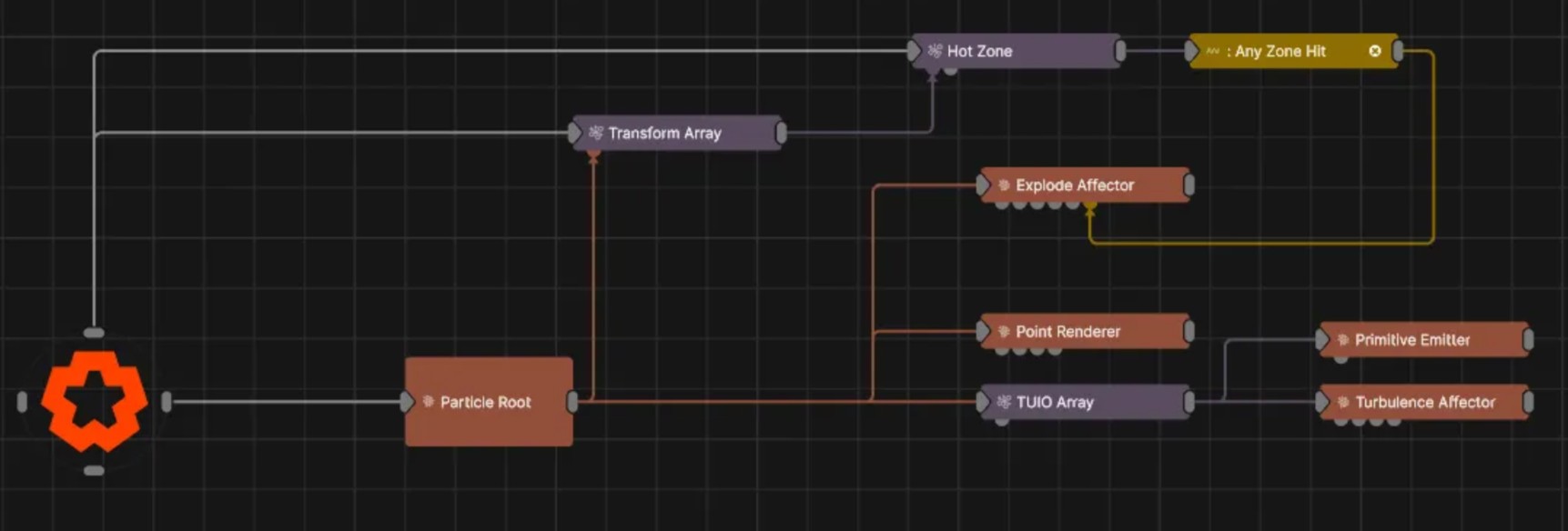

Using a Transform Array with a Hot Zone #
One other little trick that can go a long way is using Transform Arrays fed by particle systems, in combination with Hot Zones. A Hot Zone basically monitors a volume of 3D space and detects if anything enters it. You can use this to create an event or effect when a particle enters the Hot Zone.
To do this, you need to go via a Transform Array. The Transform Array can take an input from the Particle Root (to get the position of every particle in the system) or any of your Emitters (so that it just gets positions of that emitters particles).
Here’s a really simple example where the Explode Affector is activated when a particle enters the Hot Zone: Particle Hot Zones
