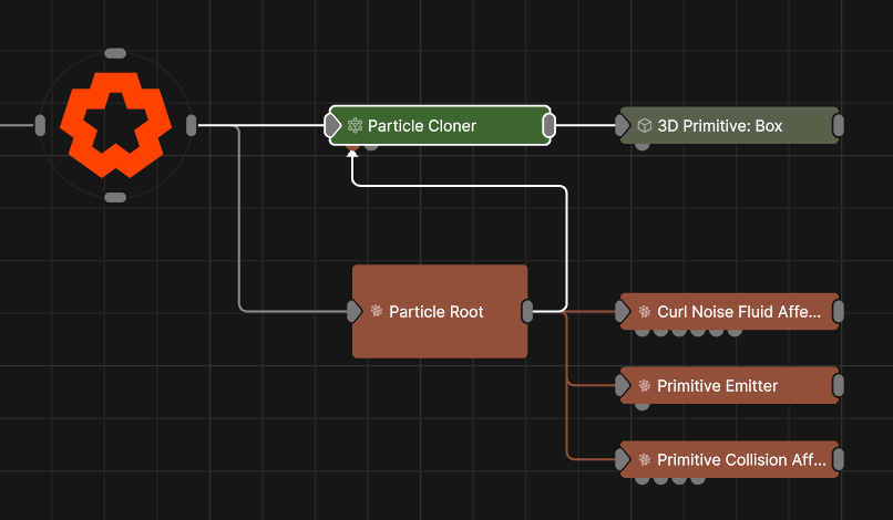

This node creates clones at positions defined by a particle system. A Particle Root Node or a Particle Emitter must be connected to the Particle Node input for this node to be operational. If a Particle Emitter is connected, then only particles emitted from this emitter are used to generate clones. If a Particle Root Node is connected, all particles under that root node may be used to generate clones.
In order to make the effect visually consistent, clones are attached to individual active particles and flow its transforms until the particle dies.
