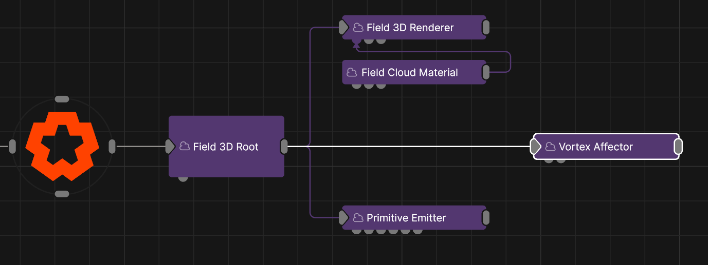

Vortex Affector
Vortex Affector
Applies a rotational velocity to a field.
This node modifies the movement vectors of a field to give a rotational velocity about an axis. Useful for creating tornado effects.
Velocity Amount Scale the generated affector velocities.
Spread Angle Controls how much the spread there is from the field velocities generated.
Vortex Angle Change how quickly field moves around the vortex centre dependant on distance from it.
Outward Velocity Control the speed at which the particles are pushed out from the vortex centre.
Randomness The randomness of the new velocities added to the simulation.
Vortex Position NodeChange the position of the point the field orbits around.Null
Falloff NodeUse an input node to control the properties of the falloff.Falloff
