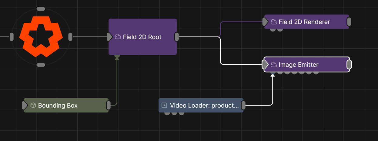

Image Emitter
Emits ink into a field from an input image.
This node emits colour/ink into a field based on an input image, useful for making 2D field effects based on a video feed.
