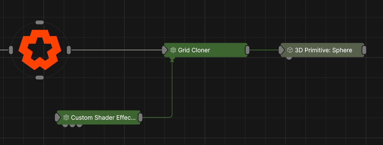

This node lets you create your own custom effectors using shader code. This is great way of expanding the capabilities of cloner systems in Notch, and with careful design and implementation can lead to endless possibilities of innovative, efficient cloner based looks. Notch shaders are written in HLSL and use the D3DX Effect framework which allows for multiple techniques and passes and access to all of the pipeline stages.
Cloner Effectors allow for the manipulation of position, rotation, scale and colours of clones, as well as the killing of clones. For an overview of cloner systems and how to use clone effectors within them, see This Article.
This node receives information on a cloner system once per frame. By writing HLSL code, you can perform operations on that data and use it to update (effect) attributes of clones. You can also define your own variables that can be controlled from the Property Editor or via Modifiers, just like other parameters in Notch.
As with all cloner effectors, the order of node’s in the node graph will impact the order of operation and therefore the behaviour of cloner effectors. This also impacts the behaviour of the Custom Shader Effector. In short, when several cloner effectors are used in combination, the effectors that are placed at the top left of the node graph will be processed first, then those that are lower down in the node graph. For more information in this, see this section on Node Hierarchy and Data Flow
Custom Shader Effectors require the implementation of your own code to determine the behaviour of the Effector, and requires some knowledge of these systems to implement. Use of custom shaders is at your own risk. 10Bit does not provide support for custom shader code. If you experience an issue with a project/block you will need to demonstrate your issue without your custom shader in the nodegraph, to be able to receive support from the 10bit team. Support is only available for issues specifically related to the functionality of the Custom Shader Node, not for any custom code. External tools are available that can provide good assistance in writing these nodes when provided with the example script.

Once you have gotten set up with the example script as shown in Set Up you are ready to start reading and customising its HLSL code.
This script uses mathematical functions to animate the scale, rotation and colour of the clones it acts on as determined by its falloff properties (the falloff applies a weighting to each clone that can be used to set how much the effector acts on any given clone).
There will be more detail in later sections, but in brief, to achieve this within this file:
  • Buffers are created to receive and hold information about the cloner system at the time the effector is applied to the cloner system. These incoming values are read once per frame.
  • Variables are created that will control the effect. These variables can be named as you chose, and can be controlled via the Property Editor or by using modifiers just like other properties in Notch.
  • The falloff properties of the node are used to control the effect on a clone by clone basis.
  • The functionality of this effector is determined inside of the function CS_ApplyEffector. This function is run once per frame, per clone. This code will run on multiple threads simultaneously.
