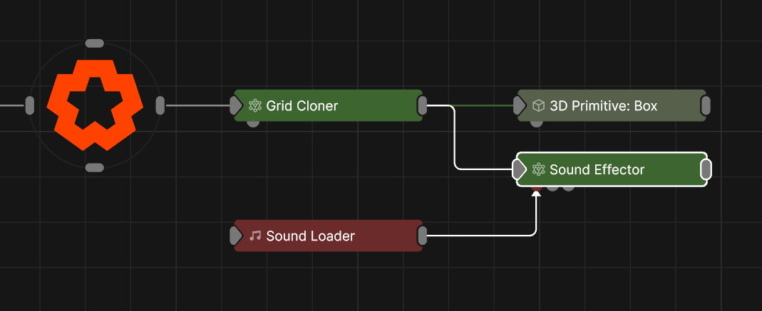

Modifies a cloner system using an audio input.
This node applies a transform to clones based on the analysis of an audio source. The waveform is processed using a set of parameters, allowing for greater control over how the sound is applied to the clones.
Sound Sound used to drive the effector. Can be overwritten by adding a relevant node to the Sound input.

SoundUse an input sound to override the sound attribute.Sound Loader
