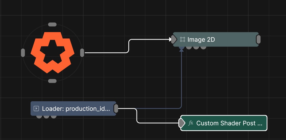

Add a custom .fx shader script as a Post-FX
See Working With Custom Shaders for an overview on managing .fx resources and HLSL scripts in Notch.
If you are working with custom shaders using an LLM based assistant, it is often best to create the Example Shader Script and upload it to be understood, as well as pointing to the Working With Custom Shaders page to provide the necessary information to get good results.
This node allows you to write your own custom shaders for use as a Post FX within the Notch nodegraph. Notch shaders are written in HLSL and use the D3DX Effect framework which allows for multiple techniques and passes and access to all of the pipeline stages. For Post FX the Pixel Shader is most commonly used for processing and effecting images.
Use of custom shaders is at your own risk. 10bit does not provide support for custom shader code. If you experience an issue with a project/block you will need to demonstrate your issue without your custom shader in the nodegraph, to be able to receive support from the 10bit team.
Shaders are resources with a .fx suffix. The most effective workflow for authoring shaders is to import your shader resource and turn on Reflect Resource Changes (right-click resource to set this). Now every time you save your shader in your text editor, the shader will be reloaded in Notch.
Any compilation errors will be reflected in the log (View -> Log Window).
