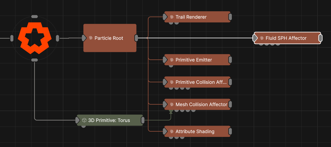

Fluid SPH Affector
Fluid SPH Affector
Simulates fluid dynamics on Particles with an SPH simulation.
This node simulates fluid dynamics on a particle system using the SPH (Smoothed Particle Hydrodynamics) simulation method. This is typically used to simulate liquid effects. It solves a fluid simulation by locally solving pressure forces between a particle and others nearby. This allows particles to affect each other and to move in a locally coherent manner. SPH works well for liquid effects like water.
The solver takes into account both the position and velocity of particles and their neighbours. The Viscosity attribute is used to make the simulation behave as a thicker liquid. Surface Tension is used to keep particles together like droplets of water. The radius around each particle in which they interact with their neighbours is controlled using the Cell Size attribute. Larger cell sizes may result in a smoother simulation that increases performance demands. The simulation may be switched from 3D to 2D, in which case one axis is dropped from the simulation.
The grid resolution and size used for the pressure solver is key to the detail and performance of the resultant simulation. A higher resolution grid over a smaller area will give a more detailed simulation, but higher resolution grids are slower to process.
