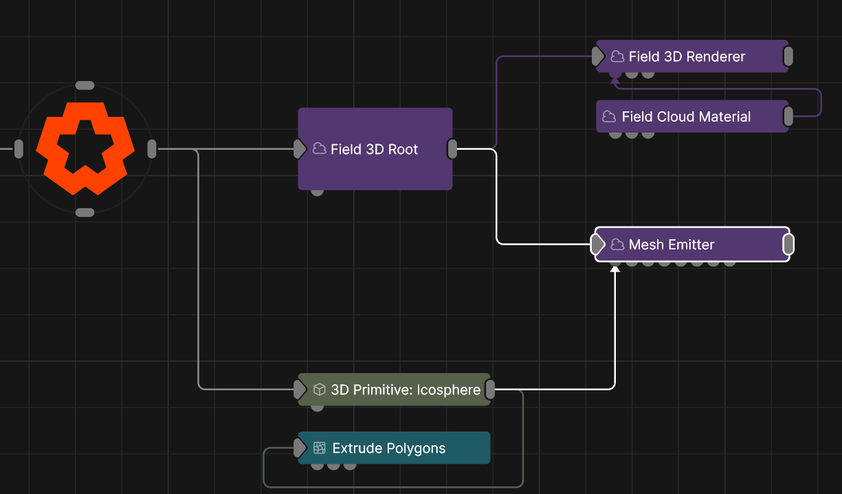

Mesh Emitter
Emits ink into a field based on an input Mesh.
This node emits colour/ink into a field based on an input 3D object. The object is first voxelised, and the resultant voxels are used to contribute ink to the field.
