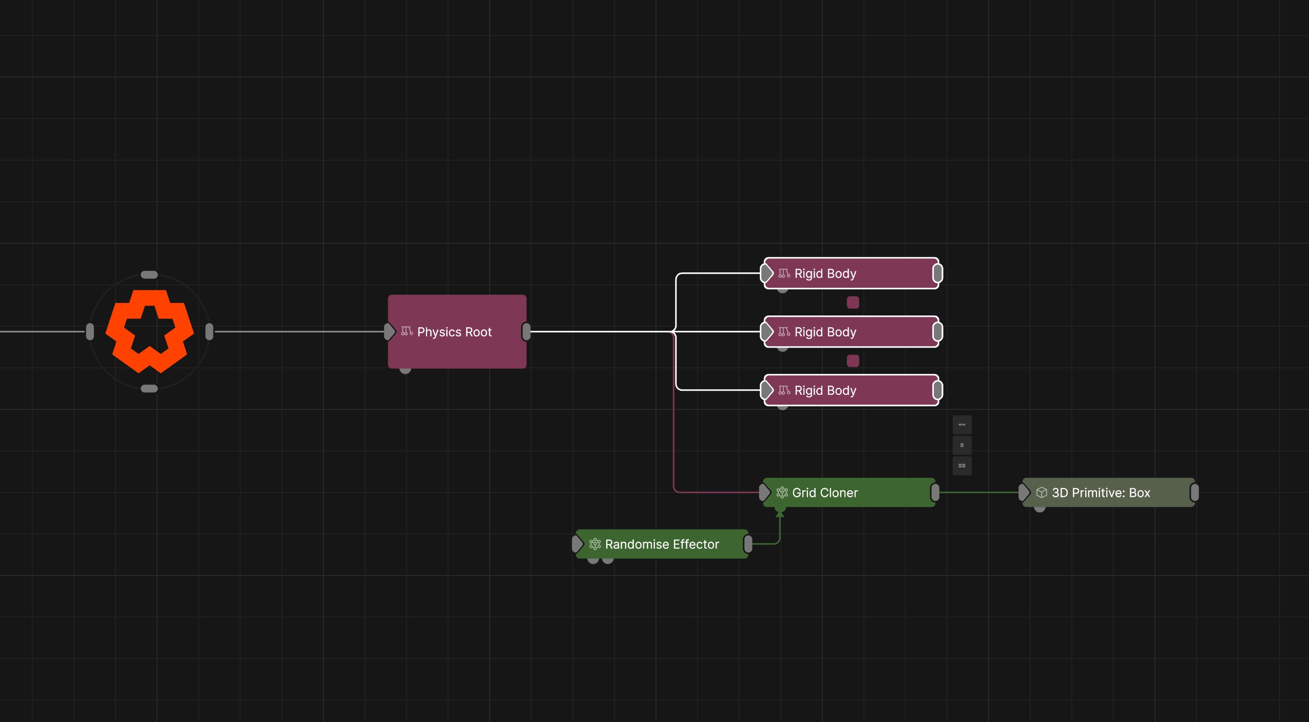

The Rigid Body node defines a static or dynamic rigid body collision object. This is a 3D body that moves under physics and collides with other objects in the same physics system - under the same Physics Root. It must be parented to a Physics Root for physics to work. Useful for quickly setting up collision surfaces, such as side barriers or angled ground planes.
